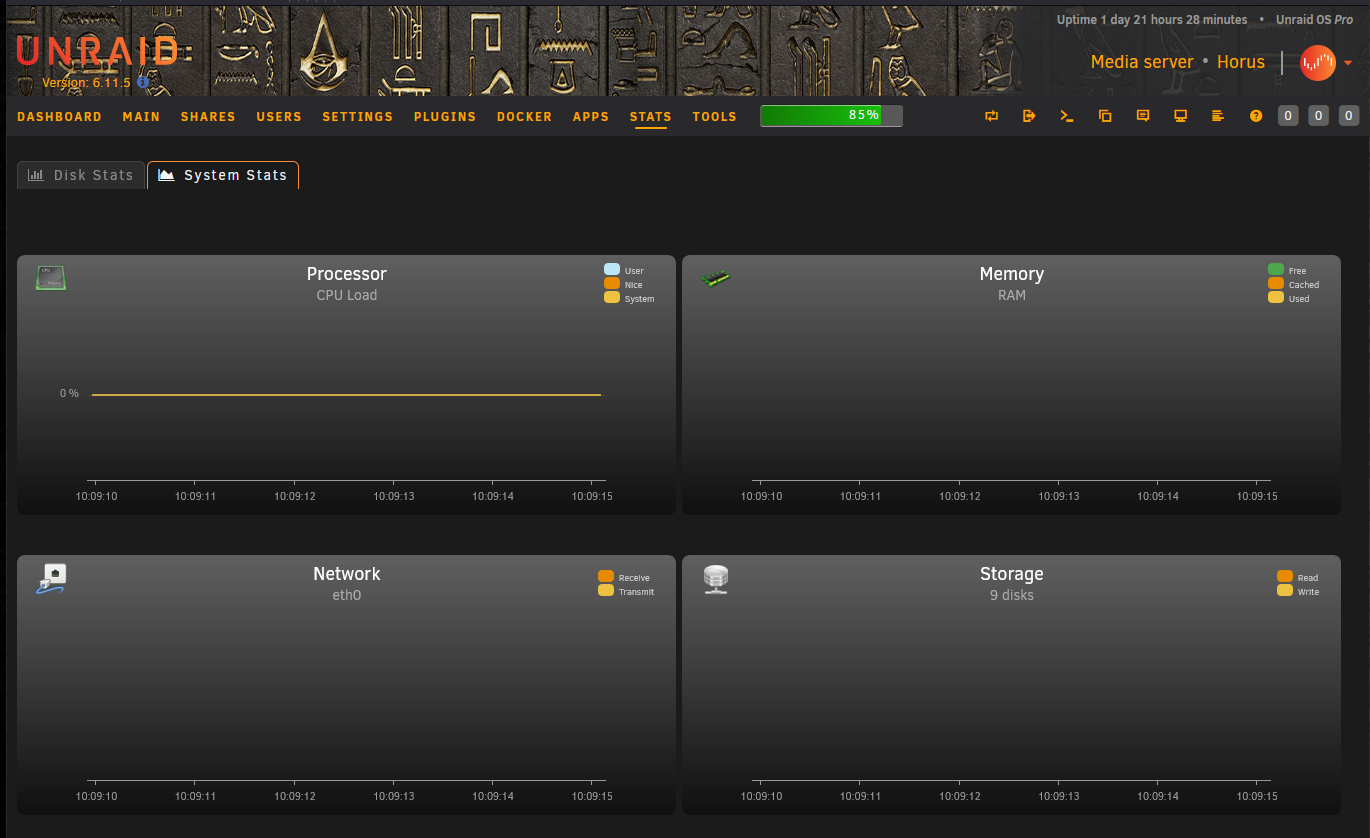

After the update to v 2023.02.05a, i see this:
...not normal (i think).

The Stats-Plugin was working before this update...
Same here, running Unraid 6.11.5 on an QNAP TS-453Be, but I don't get any Syslog Errors after a reboot. System Stats are just blank.
The latest version of System Stats uses the sa package which is provided with Unraid.
When the upgrade is performed the "old" sa package is removed and it requires a system reboot to restore it.
Thanks for your help - working 👍

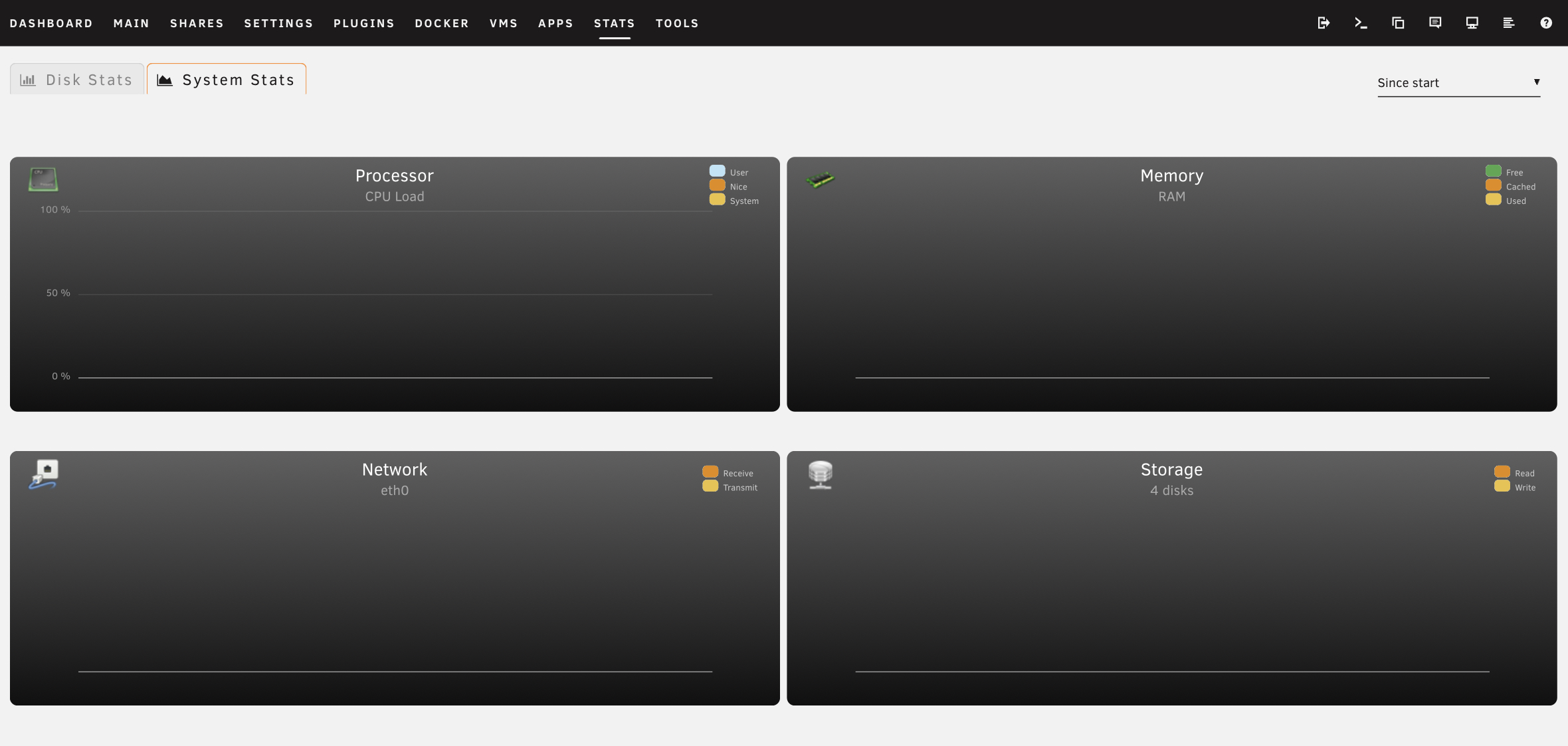

Unfortunately it doesn’t work for me like before:
I updated the package and rebooted the system. No System Stats were available.
So i uninstalled an reinstalled the plugin (with purging the old plugin files via „Apps“ -> „Previously installed“). After that i rebooted the system again to be safe.
The System Stats are now working for the Real-Time view, but not for the static views.
It will take some time to fill the database.

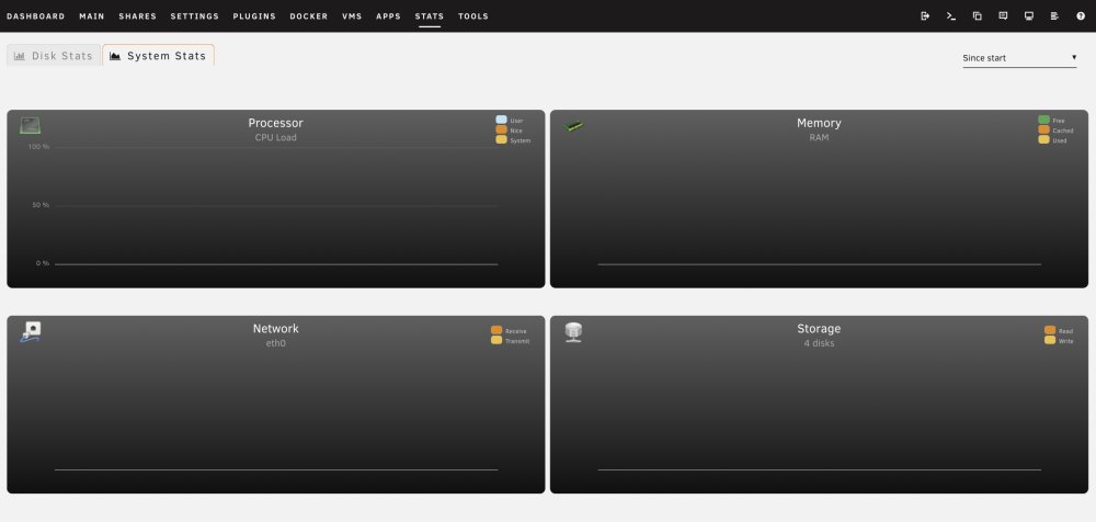

Same issue here as well - reinstalled plugin and rebooted but historical views not working.
After several days still no data and inconsistent representation of the graphs.
