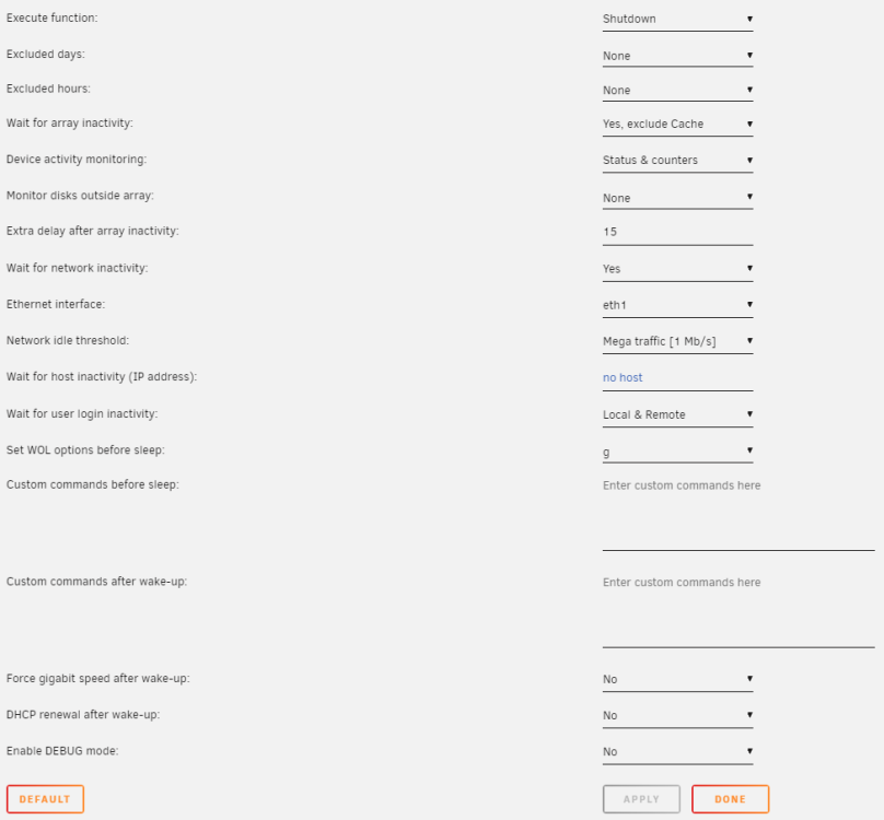

version 2023.02.05 of the plugin and unraid 6.11.5 is putting the computer to sleep too soon. it has only happened since upgrading from like 6.10.x. i have it set to sleep if all arrray disks have been spun down after 15 minutes. here is the screenshot of my current settings
if i disable the plugin, unraid works fine so im pretty sure its the plugin and even after the recent update, it still does it. i also attached a diag in case you are able to see anything more. i turn on unraid for movie nights or managing media files so its off more then its on.
server-diagnostics-20230212-2228.zip
The S3 Sleep plugin was updated to version 2013.02.13, which has a fix for devices (disks) detection. Please upgrade and try again.

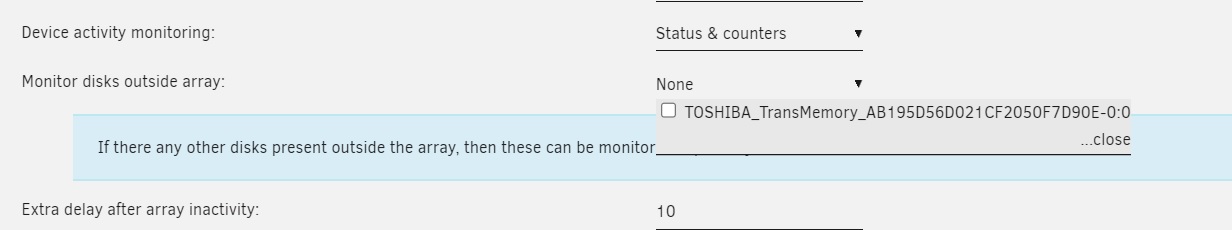

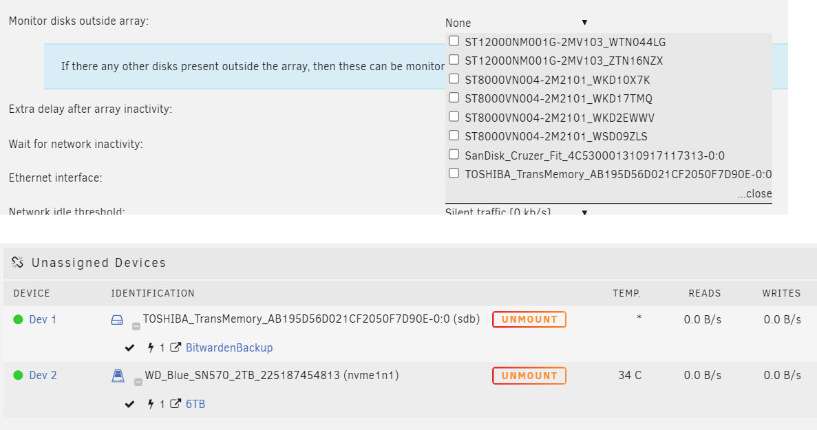

It does not seem to see my NVME WD_Blue which I'd like to select to be monitored for activity as well. :)
What is also confusing is the fact that it lists the array HDDs here.
*edit*
Updated the plugin to 2023.02.13, now the array disks and the unraid thumbdrive are nolonger listed, however my nvme WD blue is still not showing up in the dropdown menu.
Edited by cholzer

After the update, for me there is no more "monitor discs outside array" setting to configurate.
Do you still have this entry showing up on your system?
yup, but only a thumbdrive shows up there (this is not the Unraid boot stick it is also an Unassigned Device), the UnassignedDevice 2TB WB_Blue nvme ssd still does not show up.
Edited by cholzer
I made an update to fix the list of devices outside the array
Works! I see the WB_Blue NVME available in the dropdown menu again!
