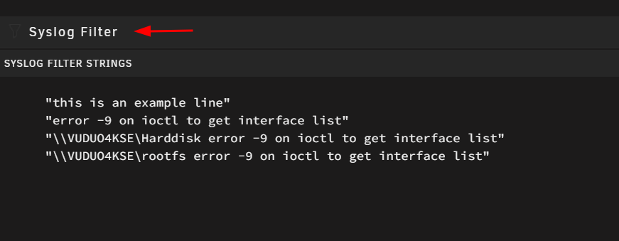

I don't need to know what the plugin is doing every time it changes fan speeds!  I not sure why it even does this by default!  Please tell me someone has a way to fix this?!?!?!
there is nothing to "fix" as its by design ... if you dont want to see those syslog messages ... and if you would have searched ... you would have found as sample the "enhanced syslog setting" plugin ... where  you can filter events to not show ...

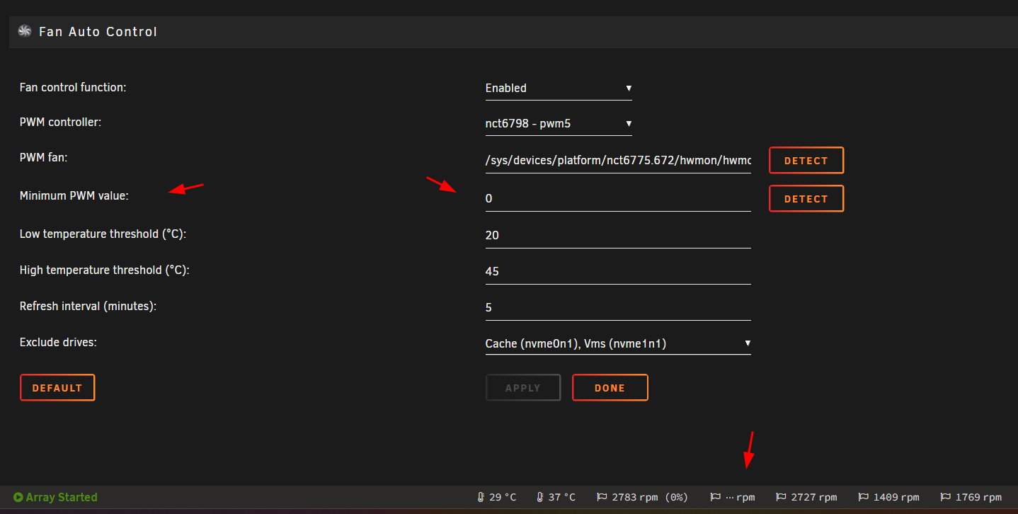

Since pool discs temperature is not reported while disks are spinned down and I have System AutoFan tied to discs temperature, the fans are stopping. I need them to be in min rpm while discs are down. Would you consider adding this as a feature (checkbox or something) ?
You need to set the "Minimum PWM Value" to something high enough to keep them spinning.  That's how I fixed mine, you might have to play with the value to find what works. 255 is "Max" - 65 works well for my system.
Edited by WackyWRZ
or may exlude the cache devices ... like here, i want the fans to turn off and dont need the nvme ssd drives as measure points ...
or like @WackyWRZ already mentioned, set a min value ...

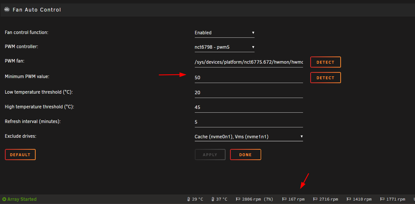

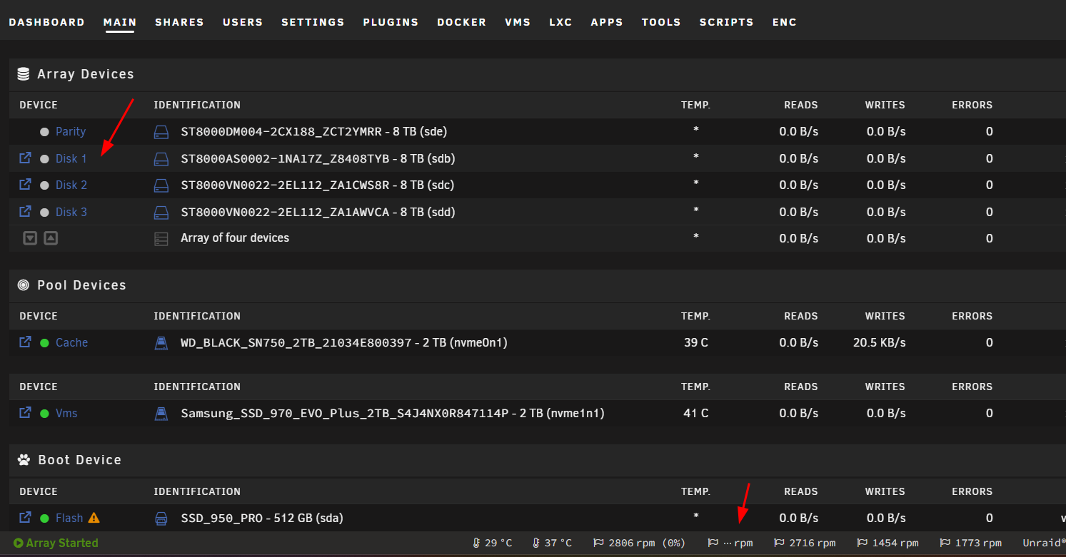

This method is not working for me. When discs spin down, their temperature is not reported and fans stop no matter what min pwm value is set to. This is why I asked for additional "check box" feature.
Edited by KrisMin
working fine here ...
sample, forced now even disks are down
normally off while disks are down
alturismo, I have some kind of anomaly then. Likely hardware related. I guess I'll make a work around to keep a couple of fans on 24/7.
