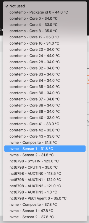

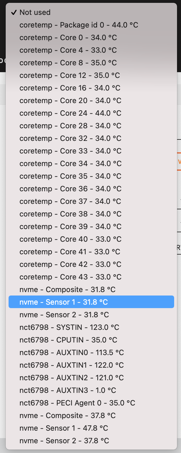

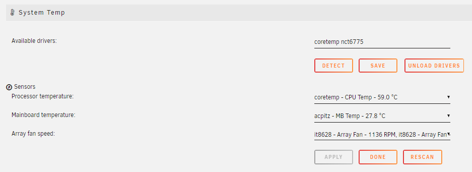

I have the system temp plugin installed for quite a while. This is my setting (motherboard: Gigabyte B560M AORUS PRO AX), not sure when and how I managed to tune it, but it works:
Go file:
modprobe it87 force_id=0x8628
Syslinux config:
System temp setting:
And the result:
All good with the exception I noticed today during boot:
Anything strange, misconfigured, weird in my settings (go file mostly)? Is there a correct/better way to setup the drivers needed to have temps and array fan speeds in the GUI?
Thanks.

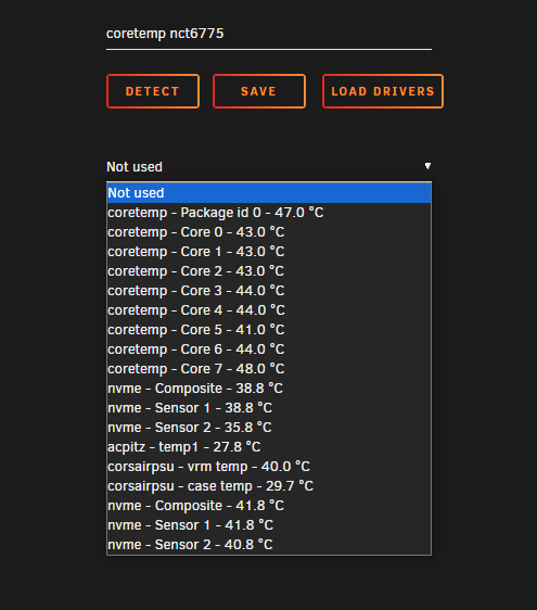

Request for feature, a plug in that allows you to display temps from all/any selected sensors detected.
corsaircpro-hid-3-2
Adapter: HID adapter
in0:          11.93 V
in1:           4.94 V
in2:           3.38 V
fan1 4pin:   1589 RPM
fan2 4pin:   1643 RPM
fan3 4pin:   1599 RPM
fan4 3pin:   1883 RPM
temp1:        +41.5°C   --- this is the probe stuffed in the LSI heatsink on my server --
the corsair commander pro has 3 or 4 temp sensors. It would be great to monitor probes placed into heatsinks to at least give a little idea of the cooling for tuning the fan plugin.

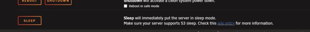

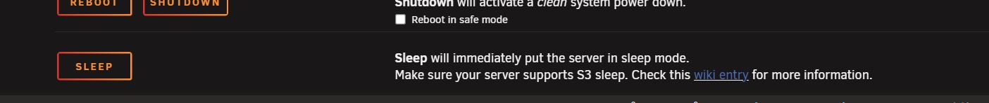

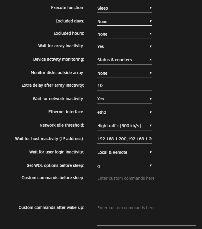

Dynamix S3 Sleep plugin is causing issues.
Currently running Unraid ver 6.12.4 on both of my Unraid computers. Yesterday I installed Dynamix S3 Sleep plugin that is available via the APPS page on ONE of my Unraid computers.
After installing I searched for documentation on how to properly set this plugin up and could find nothing.

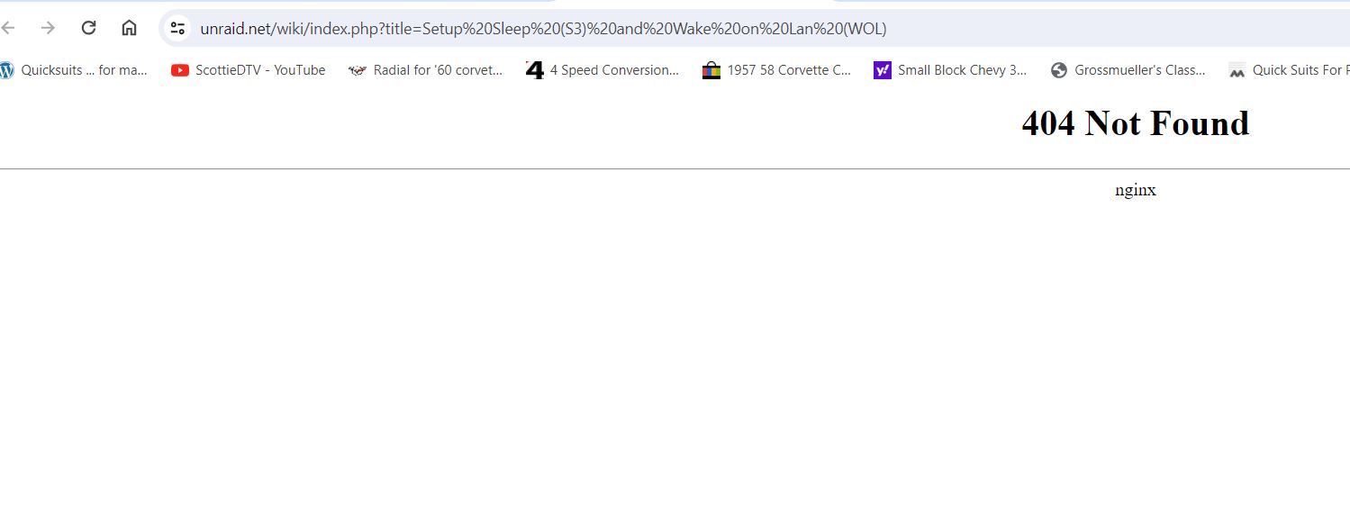

Link from the MAIN page displays the SLEEP icon and a link to wiki entry that does not work. See screen captures below.
However I did find this recommendation in this thread here that I used.
872065378_Sleepsettings.png.dbe2bed37b8e
i set them to these settings. And exited the plugin. Then went back into the settings tab to verify I had saved them. And they were saved.
Last night before retiring I pressed the SLEEP icon on the Unraid Dashboard and the server seemed to go to sleep, as I lost my web connection to the server and ALL lights and disk leds were now off.
This morning I hit my power button, The computer seemed to awake and all lights and disk leds were no on. There was no usual bootup procedure, So I assumed it was awake.
However I could not connect to the server via a browser, nor would it respond to a ping from my Windows 10 computer or Ubuntu pc.
So I had to hard reset the beast via the power button.
And now it is awake but running a parity check due to the hard reset.
I checked the plugin settings this morning and they had returned to the default settings and not the settings I had entered.
I checked my log entry for last night to see if the server did in fact go into S3 Sleep mode.
I found these entries
Mar 17 00:29:00 JUNKYARD s3_sleep: Enter sleep mode
Mar 17 00:29:00 JUNKYARD kernel: PM: suspend entry (deep)
Mar 17 09:27:16 JUNKYARD root: Delaying execution of fix common problems scan for 10 minutes
The next after were for this morning.
I've removed the plugin until I can find instructions on what are the proper settings to use. I do not want any hard crashes, as this server has been as stable as a finely tuned Chevy small block V8 until installing this plugin.
I will NOT be trying this plugin on my other Unraid server.
i usually do not have this issue with Dynamix plugins.
Frustrated with the lack of documentation and broken link.
Cheers & many thanks...
Edited by Vetteman
Correct spelling

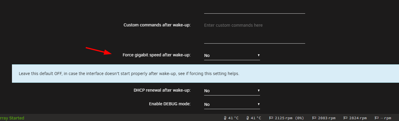

as alot are using sleep meanwhile ... i wouldnt say its a bad plugin, but what comes into here ...
Server Software in combo with alot of Hardware just dont like to suspend to ram and wake ...
there is a reason why usually its spoken, Servers dont belong to S3 ... ;)
now, there is not much you can adjust or what is correct or wrong, all you setup in the Top belongs when the sleep is auto triggered, sample from my VM Server here (which works flawlessly with sleep, luckily ...)
so, all you can try now if your Server doesnt repond after awaking ...
1/ do you have a monitor attached (or kvm) to check if the local console is up
2/ you can try the force gigabit from the buttom part (to restart the NIC)
3/ you can try various scripts before / after ... but as mentioned, in the end its usually a hardware issue which just doesnt like S3
sorry to say and may be frustrating, but nothing to be upset now vs. anyone ... its a plugin with a feature which may works (or not)
Yes, I do have a kvm switch attach. I did switch to the kvm port the Unraid server was attached to and there was no monitor display, no response from the keyboard. Sorry I did not post this.
I also watched SpaceInvader One's youtube video on this plugin
Thanks for the reply.
then the network reset prolly wont help, if the console would ve been there it would probably solvable ... but if its "stalled" after awaking ... i guess its just not your plugin.
sorry to say
Too bad. Prior to running Unraid on this computer, it was a Windows 10 storage pool server and the Windows 10 sleep mode was flawless.
I am a bit timid to try this plugin on my other Unraid server for fear of having to do a hard reset resulting in file corruption.
Thank you kindly for the replies, much appreciated. Many cheers from Nova Scotia...

It has been working just fine for many years. But I was so stupid to reinstall it cuz of another problem I tried to find.
Now when I click detect, its find the driver, and then I can see the list of sensors, I chose 1 for cpu and 1 for MB, then click apply, then I it just change to Not Used, and the list is no more. I need to reintall and reboot to get the list back, but the same keep happon.
Any idea?
After clicking APPLY
