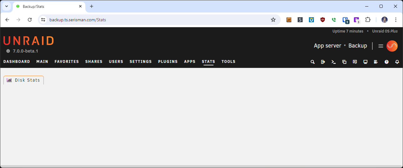

System Statistics seems to be broken with the v7.0.0 beta.  I just get an empty page when I navigate to the 'Stats' tab.  This is on a system with only a ZFS Pool where the UnRaid Array has been removed.  Possibly the plugin currently needs an UnRaid Array to operate?
