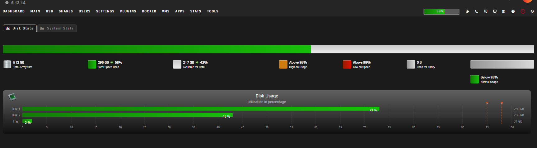

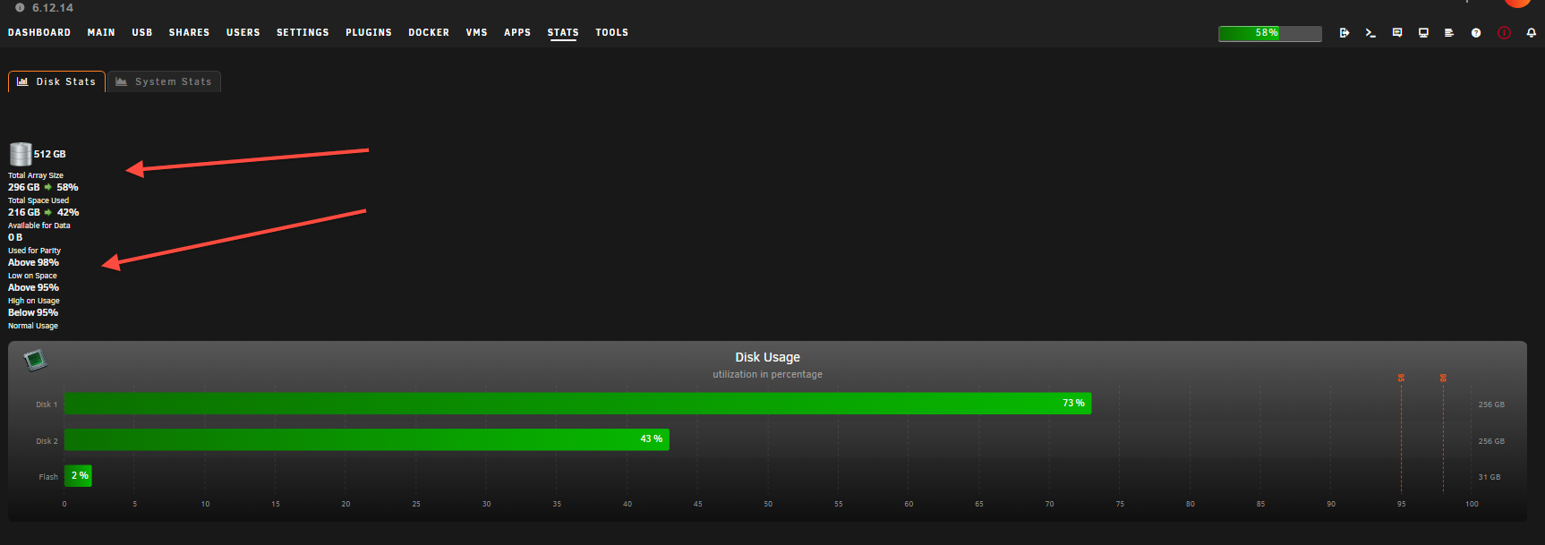

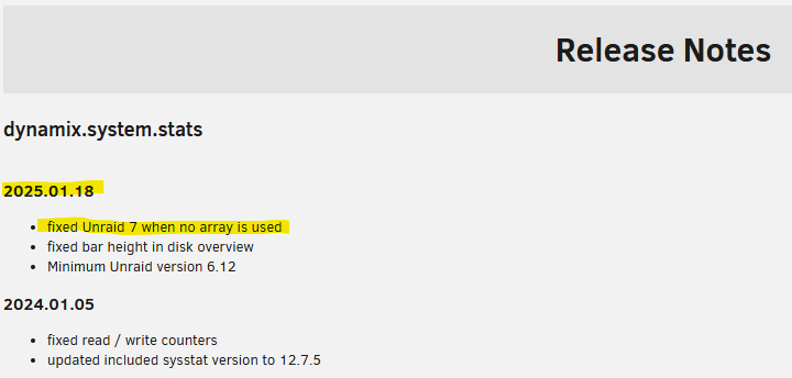

Hi, thanks for the update of "dynamix.system.stats", this works OK for unraid v7.0.0, but there's a cosmetic problem for unraid v6.12.14 :
Before update (with dynamix.system.stats v2024.01.05) :
6_12.14_dynamix.system.stats_v2024_01_05.thumb.png.6e6fc99f6e6bb1de91ca702ddcb85774.png
After update (with dynamix.system.stats v2025.01.18) :6_12.14_dynamix.system.stats_v2025_01_18.thumb.png.f890982db7a7797bab8037c683309c95.png

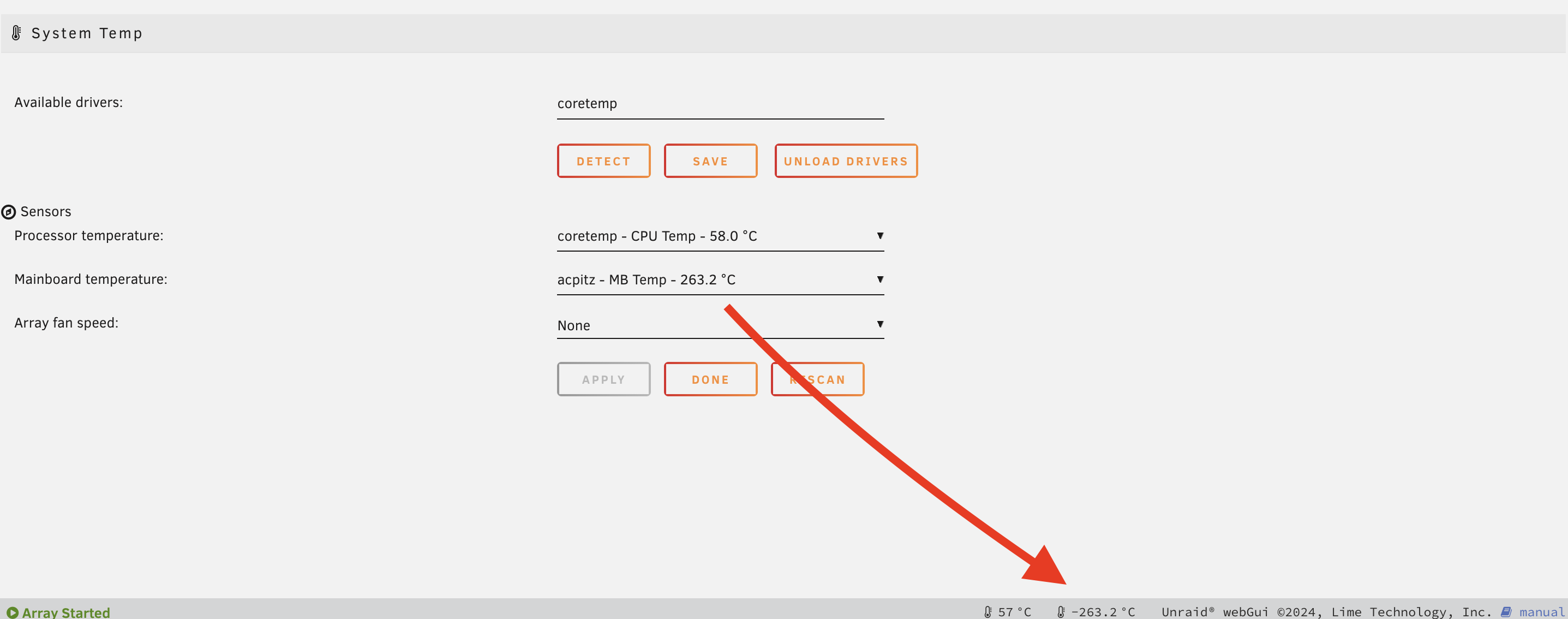

image.thumb.png.b0a1133dbd415d603211ee9dd9f5e43e.pngwrong temperature in status bar, on setting ui it's positive, in status bar is negative 263.2 °C(-263.2 °C)
