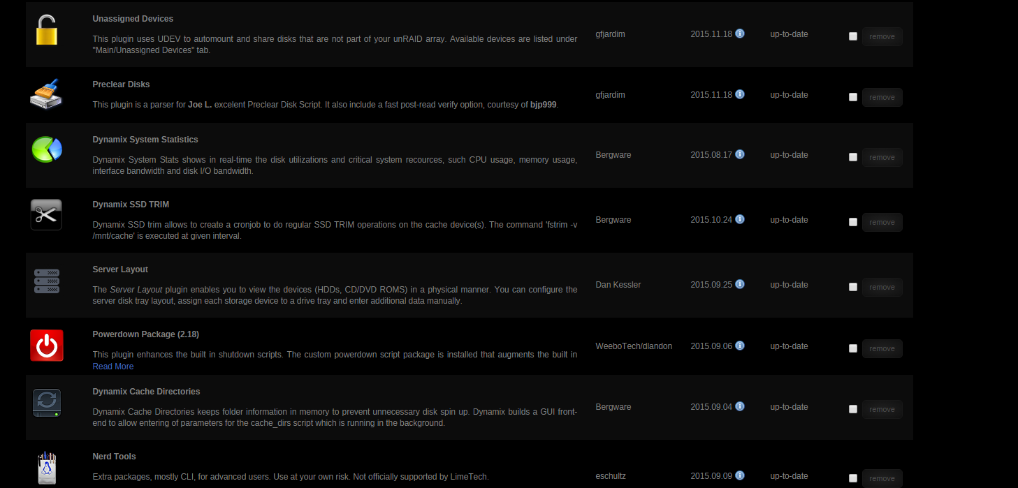

I just installed the plug in Cachedirs from the plug-in's page and the option does show up now in the settings area. But why does it not show up in installed plug-in's area in case I ever wanted to remove it from the GUI permanently? Once the plug-in is installed shouldn't it show up in the list of installed plug-in's? How would I uninstall this feature easily if I decide I don't even want it in my install? Thank you...
