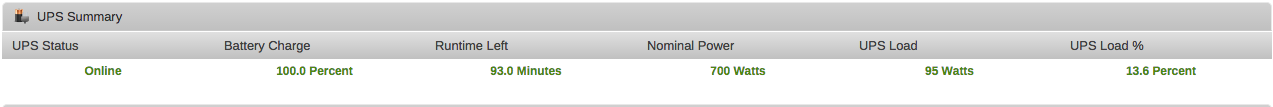

I don't know if this is happening to anybody else but the text for the ups display on the dashboard is offset to the right.
It's been like this for a while now. I have the latest bleeding edge installed.
Kevin.
Kevin.
This is not happening to me. It seems in your case text is centered instead of left aligned.
I figured it out.
It was caused by the IPMI plugin.
Removing that fixed it.
I'll pass this on to the IPMI topic.
Kevin.

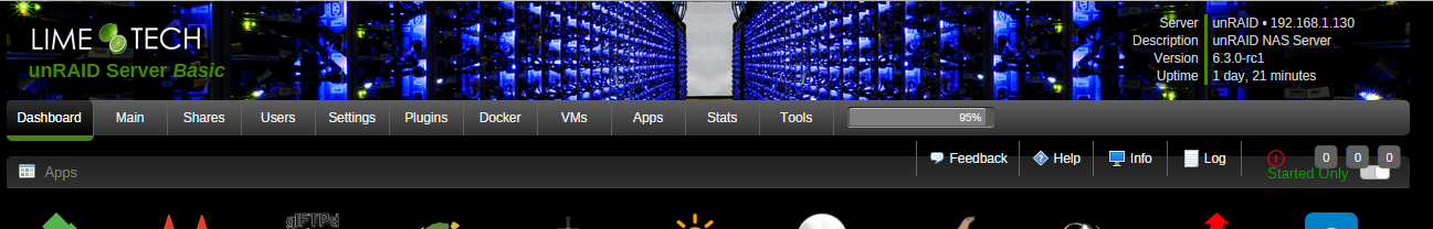

I just tried the bleeding edge, but my top menu bar seems a bit off. Not sure if this is a known bug.
I've attached a screenshot
index.php?action=dlattach;topic=36543.0;attach=37724;image
There is not enough space in the header to show all items, causing the ones at the right side to shift to the next line.
You need to create space in the header, this can be done by moving "Users" and "Stats" to the settings page.

Now it's sleek again - thanks :)
For anyone wondering how to move the tabs:
Users tab: Settings -> Display Settings -> Placement of Users menu: -> Settings menu
Stats tab: Settings -> Stats Settings -> Placement of Stats menu: -> Tools menu
