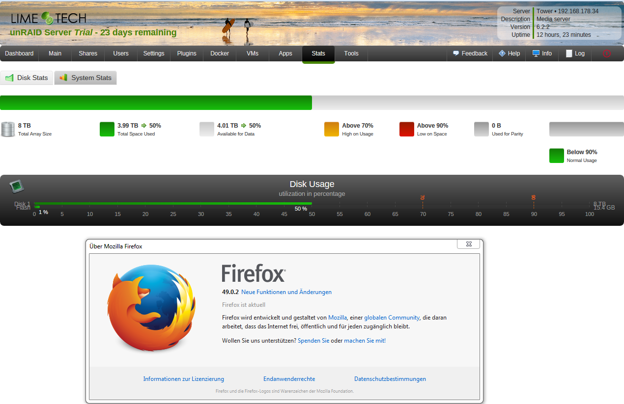

Hello, I am new to Unraid.
While copying my files to the new array, I installed the Dynamix System Statistics (2016.09.13) plugin from the official link.
However I encounter a display glitch in the disk stats tab - please see the attached screenshot.
Same picture with latest Chrome 54.0.2840.71 m (64-bit).
Is that because I have only 2 (flash and hdd) assigned devices?
Thank you.

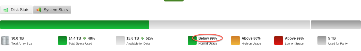

A teeny tiny buglet in Dynamix System Stats which is hardly worth mentioning but ought to be easy to fix: the "Normal usage" legend for the green bars used in the Disk Stats tab is displaying with reference to the configured critical disk usage threshold, not the configured warning disk usage threshold. In my case I have warning set to 80% and critical set to 99% so it reads "Below 99%" when it ought to read "Below 80%". A screen grab explains it better:
Link to comment
Thanks for noticing. I made a correction and will make the update available shortly.
