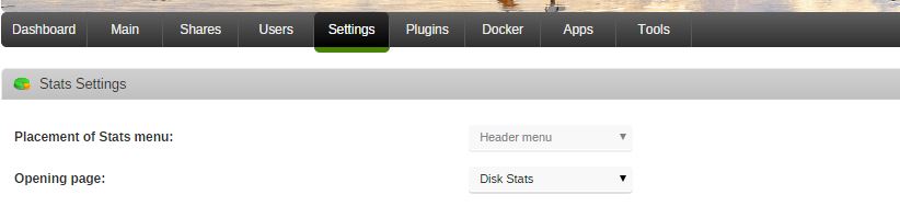

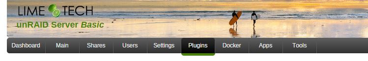

On 3/1/2017 at 11:51 PM, trurl said:
It's in Tools. You can move it to its own tab in its settings.
Hi trurl,
When i click on the Stat setting icon and go to the page i get the following. Placement is greyed out and says header but there isnt anything on the header?
Edited by finchyboyz
1 hour ago, finchyboyz said:
Hi trurl,
Is your sig correct?  unRAID 6.1.6
If your version is that old, and your plugins aren't all up-to-date, then possibly that is the problem. There was some jockeying for position between Stats, Apps, and Users with various versions of unRAID and plugins. Personally, I take Users and Stats both off the Header since they aren't used that often.
Trurl is correct. You'll need to update your unRAID version to make use of "header placement".
