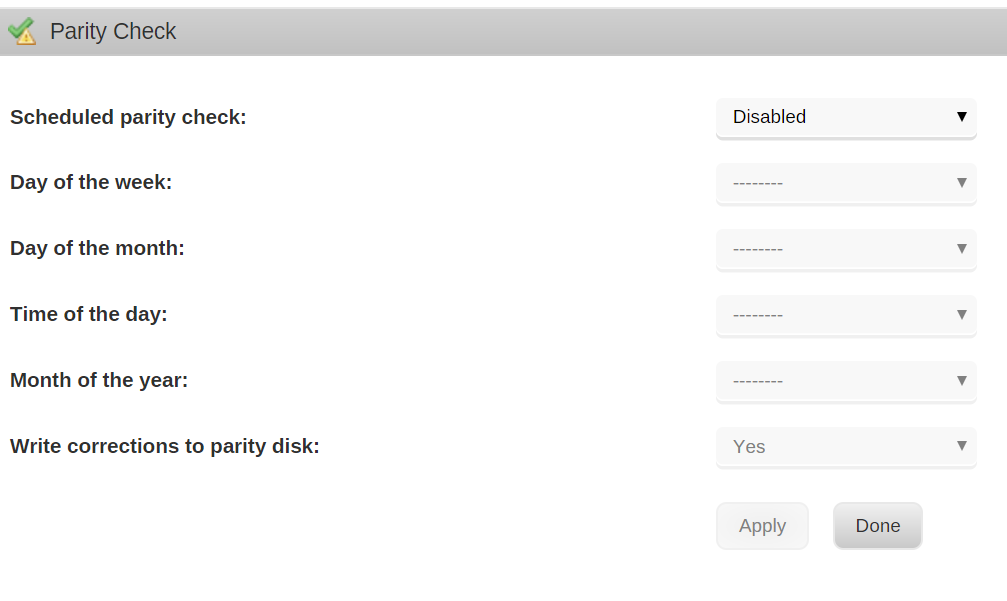

Hi, after installing trim plugin, this is what I get when I open it. Maybe something I am missing?
Rgds.
Rgds.
Scroll to the bottom of that page and you should see the trim schedule settings.

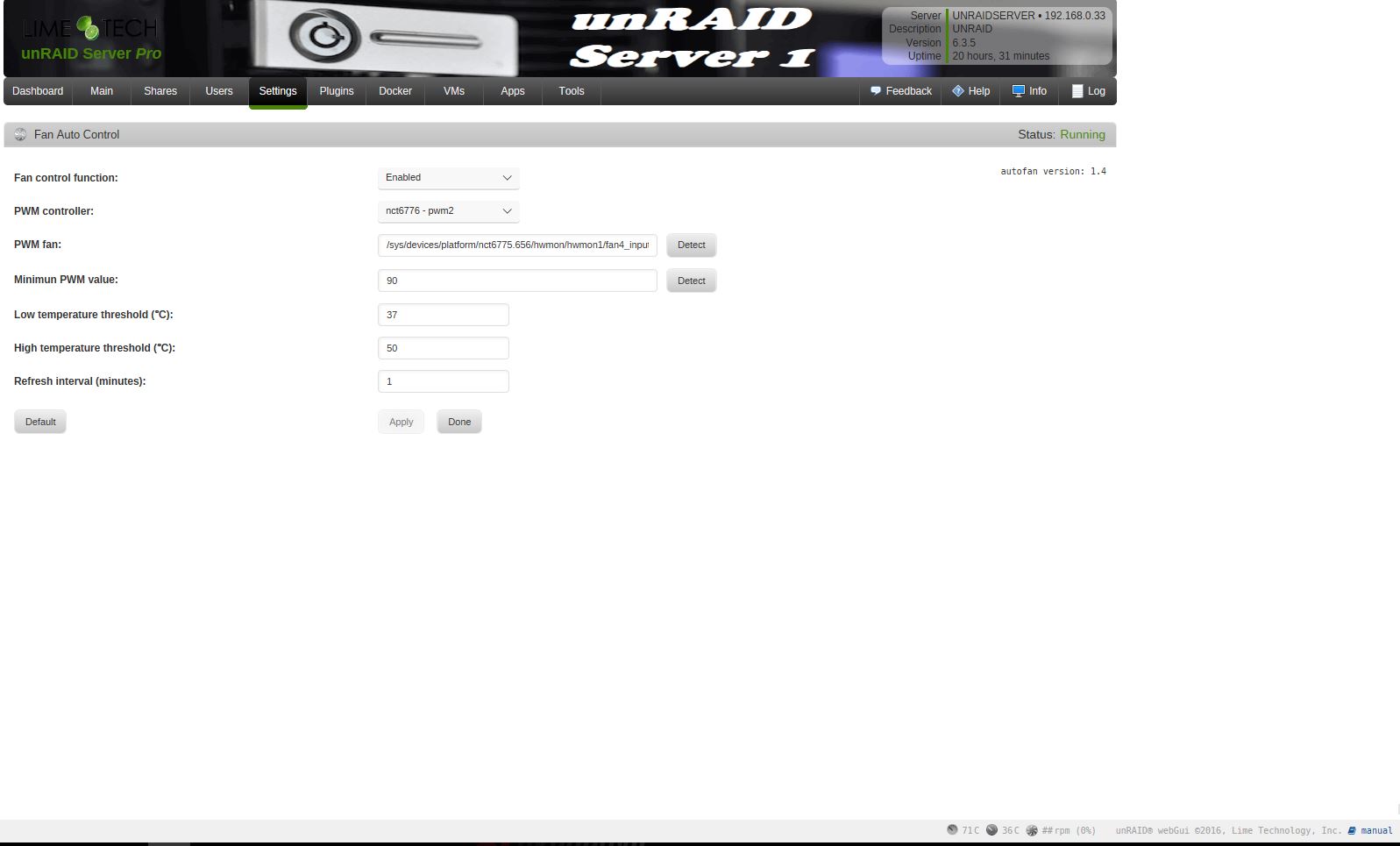

On 7/19/2017 at 11:04 AM, mbc0 said:
I am having some problems with System Autofan not reacting to my CPU Temp.  It all used to work perfectly but I changed motherboards for a totally different reason, it never worked out so I have gone back to my original Motherboard (ASRock - H77 Pro4/MVP) all sensors are detected and when clicking Detect the CPU fan drops to it's lowest speed and then back up again as it always did but when my CPU starts being thrashed the fan speed stays at 25%.  If I disable fan speed at this point then the fan jumps to 100% Where can I go from here? what logs/info can I provide?
Many Thanks in Advance...
I have tried using CPU Fan Headers 1 & 2 with the same results, when detecting, the CPU fan goes to max RPM then min (stops) and just does not respond to the cpu temp increasing? I have attached some screenshots
Hi, no option to scroll down further! I checked in mozilla and chrome. Maybe clean cache? Any idea how to solve this?
Do you actually have an SSD as a cache drive? or is it an unassigned device?  IIRC the plugin only displays the settings if you have SSD Cache (but it'll work with all SSD devices attached)
no cache ssd. 2 ssd´s assigned in unassigned devices. so the plugin should work with my 2 UD ssd´s.
It will work, but unfortunately, it's not going to be enabled, and the way that it's set up you can't enable it.  (Perhaps @bonienl will adjust the plugin in the future to not have the restriction that a SSD cache must be installed for the UI to appear)
What you want to do is create this file on the flash drive
/config/plugins/dynamix.ssd.trim/ssd-trim.cron
# Generated ssd trim schedule:
0 0 * * * /sbin/fstrim -a -v | logger &> /dev/null
Followed by this command:
update_cron
(This'll run the trim everyday at midnight)
Alternatively, since you don't have a cache drive installed, it's just as simple to install the user scripts plugin, and have a script that is simply
And then use user scripts to manage when it runs.  (Doing it this way you can also uninstall SSD trim, as there's no requirement for it to be installed)
Edited by Squid
Great! Will have a look at your solution adding a script.Thx!
Can anyone help with this please?

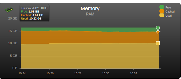

Does anyone know why Dynamix Stats and the Dashboard/top show WILDLY different RAM usage?  This is what I am seeing on my system with 16Gb of RAM
Top:
KiB Mem : 16456200 total,  1648428 free,  5736864 used,  9070908 buff/cache
KiB Swap:        0 total,        0 free,        0 used.  8231952 avail Mem
Unraid Dashboard: 50%
System Stats: (see attached)
Edited by yippy3000
This Plugin isn't working for me either, doesn't matter what the "Threshold" is, the fan doesn't change based on the what I set the CPU sensor to in the System Temperature plugin.

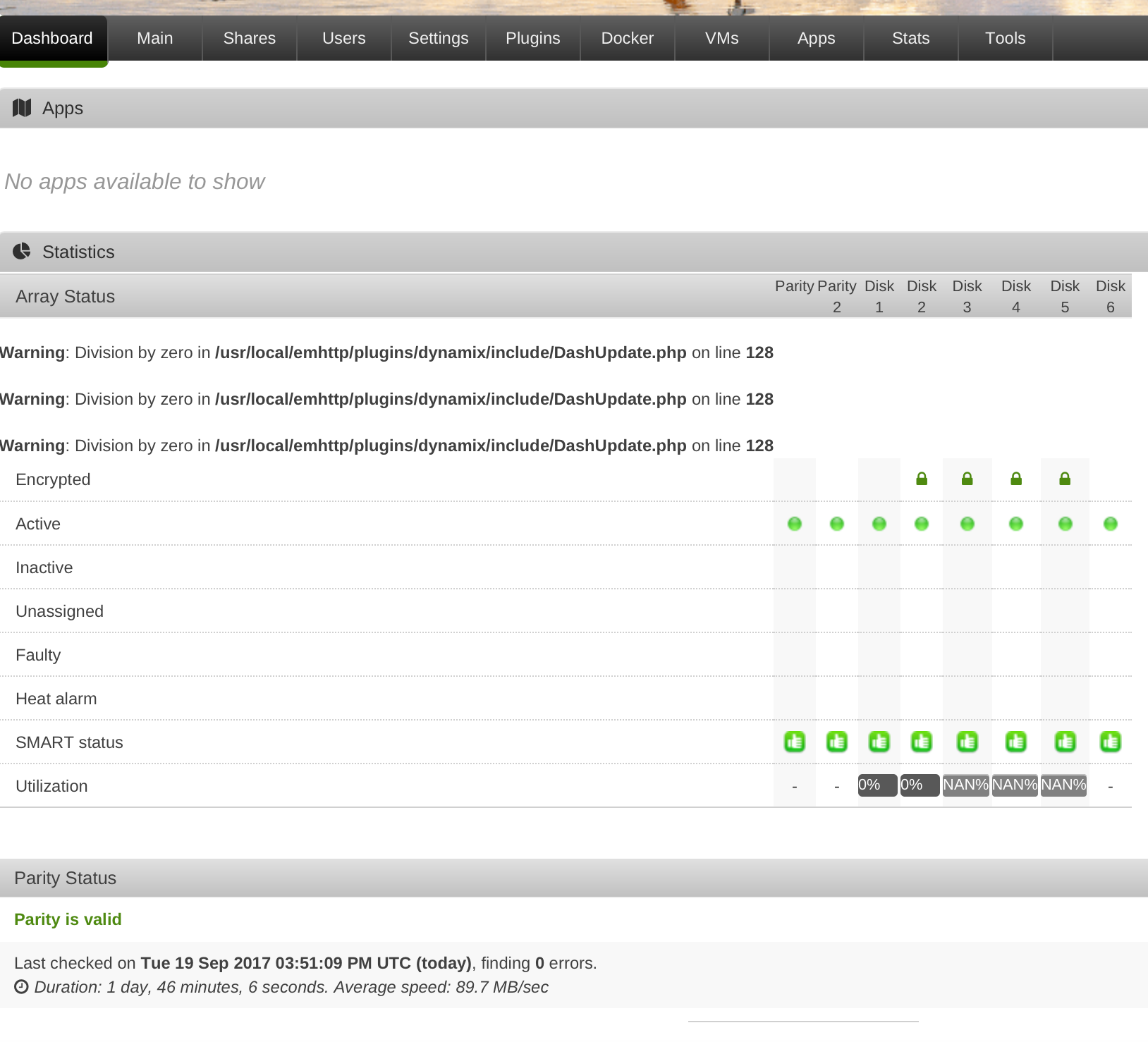

Division by zero in /usr/local/emhttp/plugins/dynamix/include/DashUpdate.php on line 128
I am adding four new disk drives to an array. After clearing they all showed up as unformatted as expected. After clicking on format, it took a while, then I got the divide by zero error for one after the other. The screenshot is taken after the third error popped up. The new drives are 3 to 6
I assume it is just a display issue, what do you think?
Edited by tstor
Yeah, a GUI glitch. Corrected in the next unRAID version.

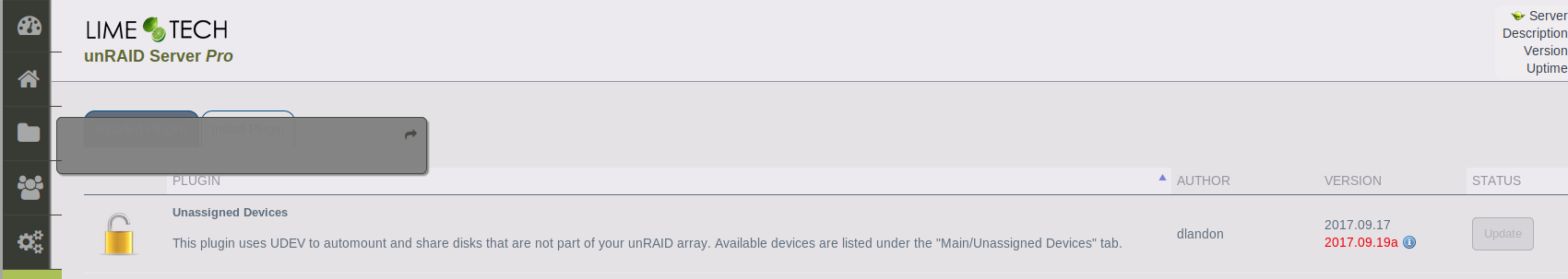

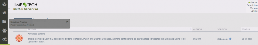

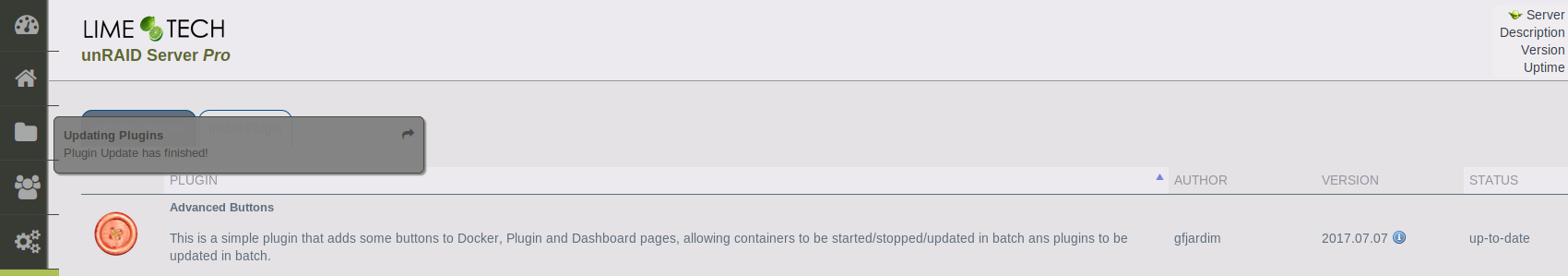

@bonienl One little thing I've noticed, when updating plugins on the new look webui, the notifications in the browser are often just a grey box with no text.  I'm using Chrome, but I'll try and remember to check with Firefox as well!
OK, as luck would have it, there was just an Unassigned Devices update....  The below was done with Firefox and definitely affects Chrome too.
After clicking update
59c172d05c582_Screenshotfrom2017-09-1920-39-51.thumb.png.190051bb30225252ed317bb46cbcbc38.png
After a browser refresh....
59c172e1f3d99_Screenshotfrom2017-09-1920-40-18.thumb.png.438ac2649be4f54a701bc3728b00eac9.png
Edited by CHBMB
How do these empty notifications look in Archived Notifications? Are these empty too?
