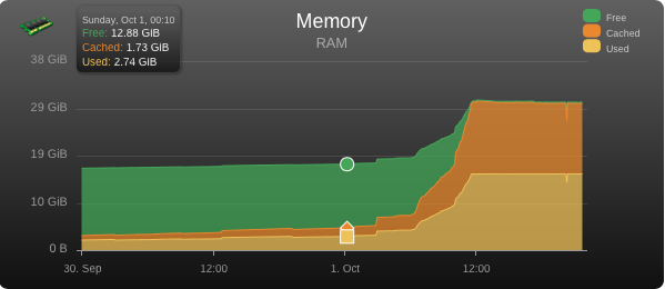

I like the fixed CPU scaling option - I never understood why in automatic mode it displayed up to 150%, which can never be reached.
However, I'm seeing the RAM size miscalculation with version 2017.10.01a too with both unRAID 6.3.5 and 6.4.0-rc9f:
59d15411b1c35_ScreenShot2017-10-01at21_41_13.png.29e5d00dcca6ee5ed46214f2c4ab56f5.png

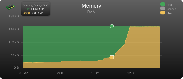

I actually have 16 GB of RAM. It looks as though the Used value needs to have the Cached value subtracted from it. If I switch off the Cached plot the graph shows the total as constant at 16 GB that I expect:
59d1564305eba_ScreenShot2017-10-01at21_49_46.png.3c4d67332a1fad8662c71104a29021a6.png
