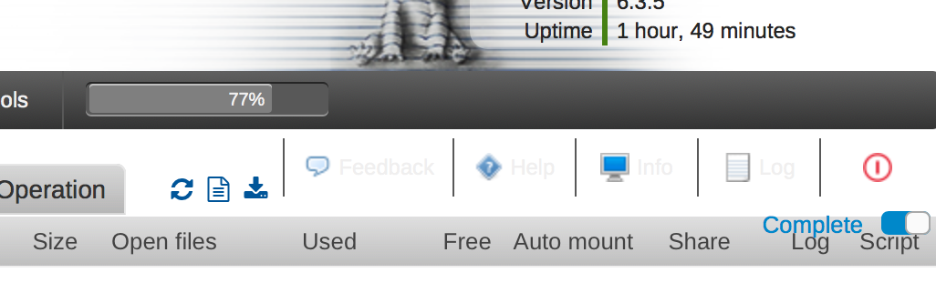

hi bonienl. could you please make System Buttons responsive?
I often check the page with my iPhone or iPad and the buttons are taking a lot of space. maybe after a certain size you can hide the labels and just offer the icons?
its just cosmetic but never the less it would make it perfect.

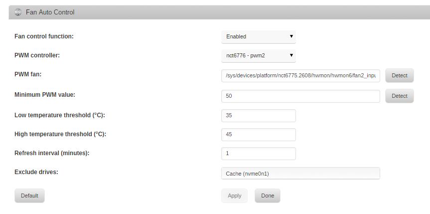

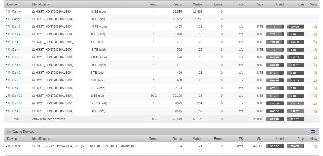

Thanks for updates to Dynamix Fan Control - ignore drive feature will really help with fan noise.
I'm posting also to document a couple of anomalies regarding implementation:
 NVME drive (Intel 750 AIC) is visible in Dynamix Fan Control, and able to be "checked"  to ignore, but does not seem to be actually ignored.  Previous to update of plugin, fans would idle at 800rpm, now around 1300rpm since nvme drive began being displayed in plugin.
Main menu view shows NVME drive listed under cache devices, but temp is never displayed, even when cache drive is active.
System log shows fan speed being adjusted in response to 37C temp, but none of the spinners are near that temp.
Oct 22 11:52:23 unraid-one emhttp: err: shcmd: shcmd (612): exit status: 25
Oct 22 11:52:50 unraid-one autofan: Highest disk temp is 36C, adjusting fan speed from: 90 (35% @ 1632rpm) to: 70 (27% @ 1616rpm)
Oct 22 11:55:55 unraid-one autofan: Highest disk temp is 37C, adjusting fan speed from: 70 (27% @ 1618rpm) to: 90 (35% @ 1628rpm)
Screen shots and diagnostics attached.
Very impressed with development this last year - finally retiring the last of H/W raid!
unraid-one-diagnostics-20171022-1125.zip

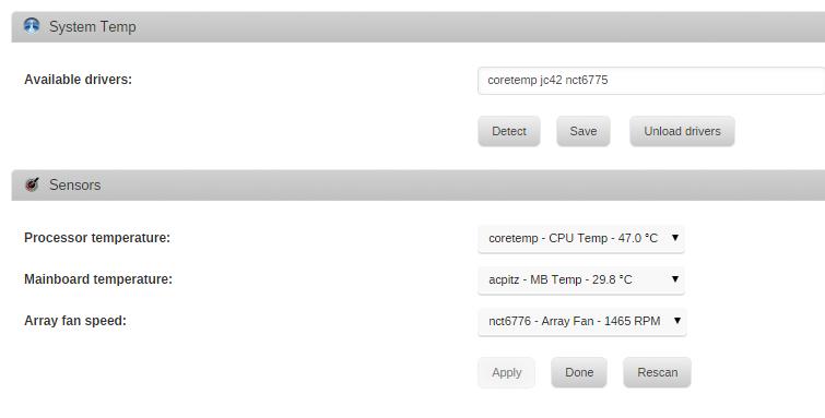

I have a System Temp driver issue.  It's a new ASROCK Z370m PRO4 board.
When I run sensor-detect I get the following:
Intel digital thermal sensor...                             Success!
    (driver `coretemp')
Trying family `VIA/Winbond/Nuvoton/Fintek'...               Yes
Found `Nuvoton NCT6683D eSIO'
    (address 0xa10, but not activated)
From my research, the Nuvoton NCT6683D eSIO needs the nct6683 driver.  I don't think it's in the build.
Here's the end of the sensors-detect run
Driver `coretemp':
  * Chip `Intel digital thermal sensor' (confidence: 9)
Do you want to generate /etc/sysconfig/lm_sensors? (yes/NO):
To load everything that is needed, add this to one of the system
initialization scripts (e.g. /etc/rc.d/rc.local):
#----cut here----
# Chip drivers
modprobe coretemp
/usr/bin/sensors -s
#----cut here----
You really should try these commands right now to make sure everything
is working properly. Monitoring programs won't work until the needed
modules are loaded.
Unloading i2c-dev... OK
My drivers.conf contents:
coretemp
My sensors.conf:
# sensors
chip "coretemp-isa-0000"
label "temp1" "CPU Temp"
label "temp2" "MB Temp"
The System Temp plugin only shows those two sensors above.
sensors command returns:
root@tdm:~# sensors
coretemp-isa-0000
Adapter: ISA adapter
CPU Temp:     +33.0°C  (high = +80.0°C, crit = +100.0°C)
MB Temp:      +33.0°C  (high = +80.0°C, crit = +100.0°C)
Core 1:       +31.0°C  (high = +80.0°C, crit = +100.0°C)
Core 2:       +33.0°C  (high = +80.0°C, crit = +100.0°C)
Core 3:       +31.0°C  (high = +80.0°C, crit = +100.0°C)
Really not sure where to go from here.  I tried using the plugin to detect but coretemp is it's only find.
This site looks like it's the driver page for the Nuvoton NCT6683D eSIO chip.
https://github.com/groeck/nct6683
3 years old so I don't know if these drivers need to be requested in UNRAID or not.
Any help would be most welcome as the server will sit in a cupboard in the tropics and I need to be able to see what the temp is like.
