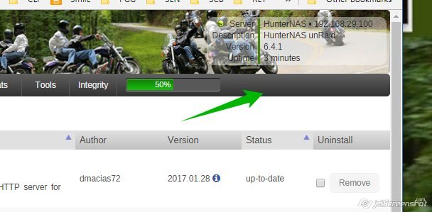

I'm at UR 6.4.1.  Have the latest version of buttons and plugins running.  But the buttons have stopped showing up this week after a reboot.  I still see Dynamix system Buttons in the Plugins, but don't see anything displaying in the GUI.  No buttons, no Log Tail, etc.  Any ideas/
Edited by jeffreywhunter
Link to post
Try making the window larger

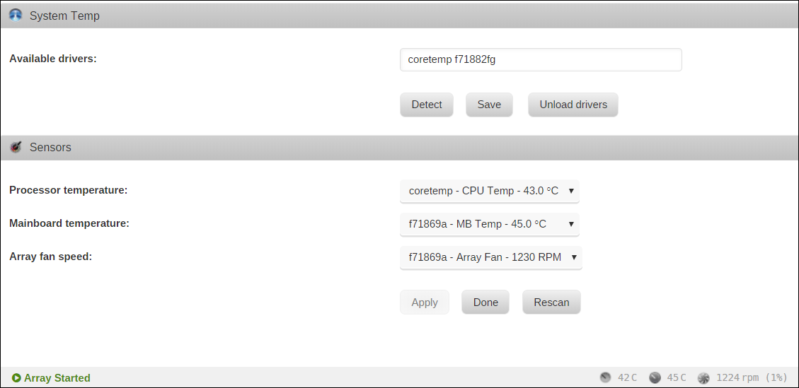

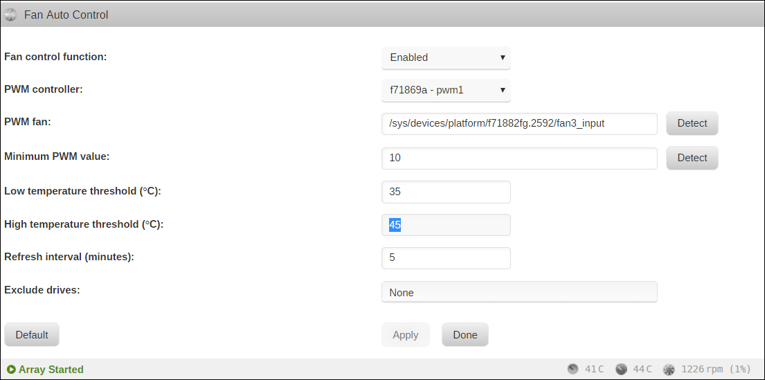

Please forgive me for asking, but how to I configure Autofan plugin?
I have both System Temp and AutoFan Control installed, but my fans is constantly doing 1200+RPM on low temperature, and I dont know wich numbers to manipulate in order to lower RPM.
Attached I have my current settings:
Link to post
