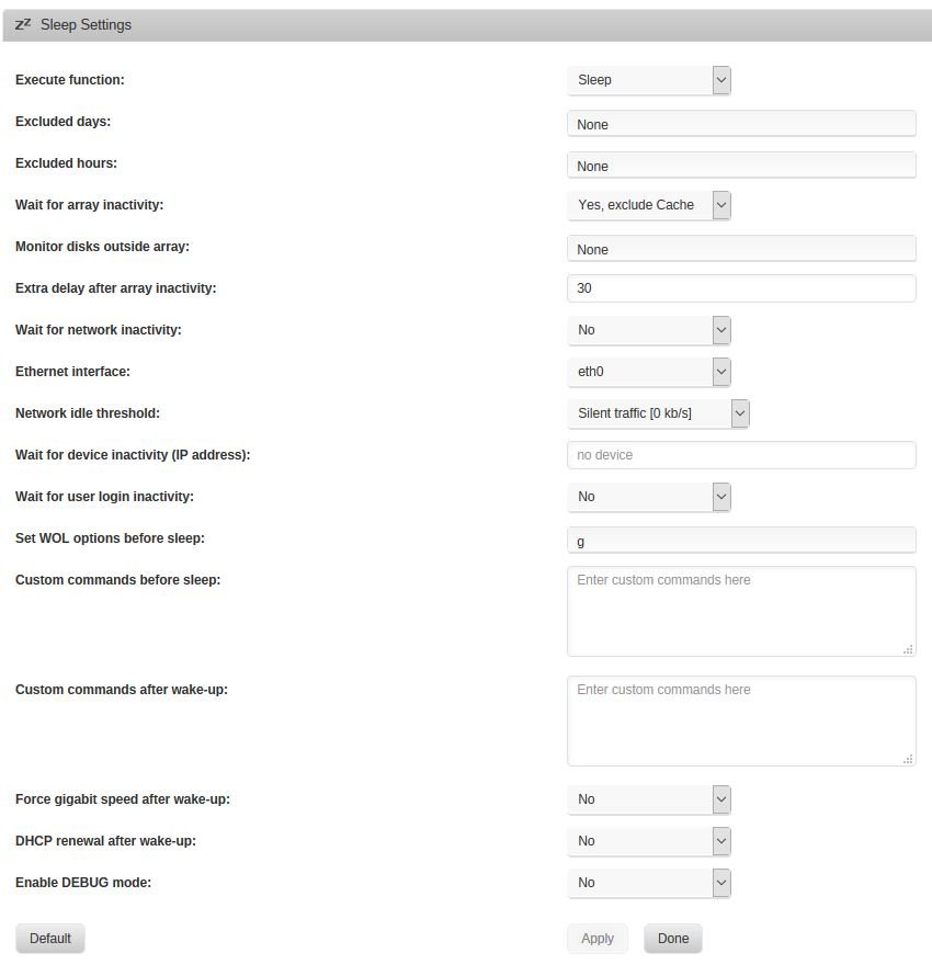

Hello bonienl - I am finding that while my server responds to the Sleep button on the UI, it is ignoring the S3 Sleep plugin when left idle. I am fairly sure I have enabled S3 Sleep in the BIOS but since the server is running headless it is not convenient to get a monitor on it.
Is there a terminal command to check whether S3 Sleep is firing as expected and if any messages are returned indicating why it was prevented from sleeping?
The server spec is as in my signature.
The Sleep Plugin causes trouble for quit some time.
A while ago i have posted a modified version here which works really good for me: https://lime-technology.com/forums/topic/34889-dynamix-v6-plugins/?do=findComment&comment=653280
I would still like to know what to look for to see why S3 Sleep is not performing as it used to. Any advice on what I should search for in the logs?
