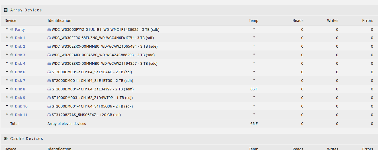

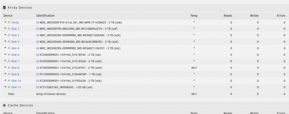

On 11/13/2018 at 6:07 AM, Walter S said:
I have a question with the S3 Sleep plugin.  The issue I have is when I set it to “Wait for array inactivity” “Yes, exclude cache”  It still refuses to go to the sleep mode.  I noticed, on the main page with all drives spun down a Temp for one or more of the drives stays and doesn’t turn to *.  Could this be why the system thinks it still up and not inactive? Preventing it from going to sleep.
335703380_Screenshot_2018-11-12ServerMain.thumb.png.32e5d31e0c1d71208230aff7216f9d03.png
Any thoughts would be helpful.

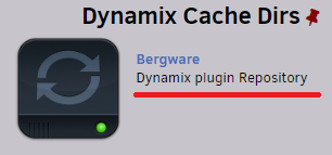

3 minutes ago, wgstarks said:
Ok. How do you know which one you’re downloading from CA? The only one I see says “Author: bergware”. Is the the alex r berg version or the bonienl version?🤔
Coincidence in the name, but Bergware is the name under which I (bonienl) release the dynamix plugins.

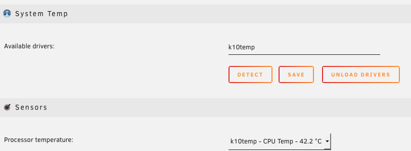

Testing with a 1950x on a Desginare X399
On 11/12/2018 at 11:34 AM, John_M said:
You can type 'k10temp' manually, then click Save, then Load drivers. Worth a try?
So initially clicking on Detect didn't do anything.
typing Sensors or k10temp into the field allows the plugin to pull in the temps. But, only two sensor readings.
The k10temp module only reads the processor's onboard sensor. Hence Tdie. Tctl is the same as Tdie but with an offset of +27 degrees C for some processors. If you want to read motherboard temperature and fan speed sensors you need a module for your particular Super I/O chip.

6 minutes ago, Zer0Nin3r said:
Is there a benefit to the ~+27 C for some processors?
Tctl is used by the motherboard to control the cpu fan. Here's the best explanation I can find:
it may be offset on certain CPU models so that all models on the AM4 Platform have the same maximum tCTL value. This approach ensures that all AMD Ryzen™ processors have a consistent fan policy.
Threadripper uses a +27°C offset. So average temp of the dies is 43°C but to make sure fans are running 'fast enough', fan curves should use the 70°C mark.
