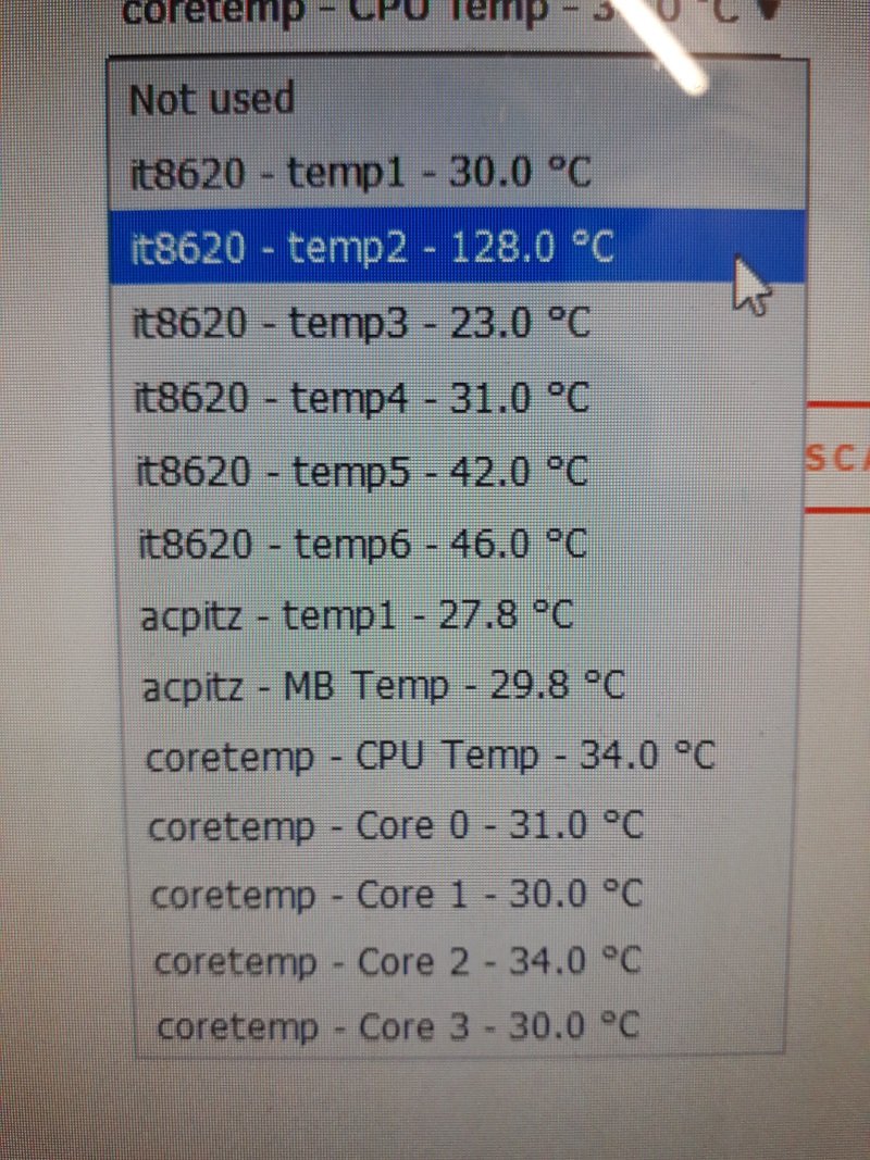

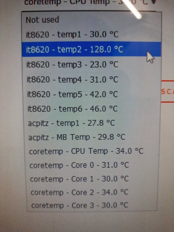

I installed the Dynamix System Temperature plugin today (along with the nerdpack for PERL) and I got some "funny" readings.
I dunno what it8620 - temp2 is but i know for sure that nothing is cooking..
Share this post
Link to post
Is this an academic question?   You can only display two temperatures out the (in your case) thirteen shown in the table.  I have two temperatures on one of my servers that are in the range of 128C.  I would simply pick two that seem indicate the true temperature states of the CPU and MB.  (I personally went with the highest one for each.)
Share this post
Link to post
sjoerd - you may find that the odd temperature is actually measuring Temperature TO a Threshold rather than actual temperature.

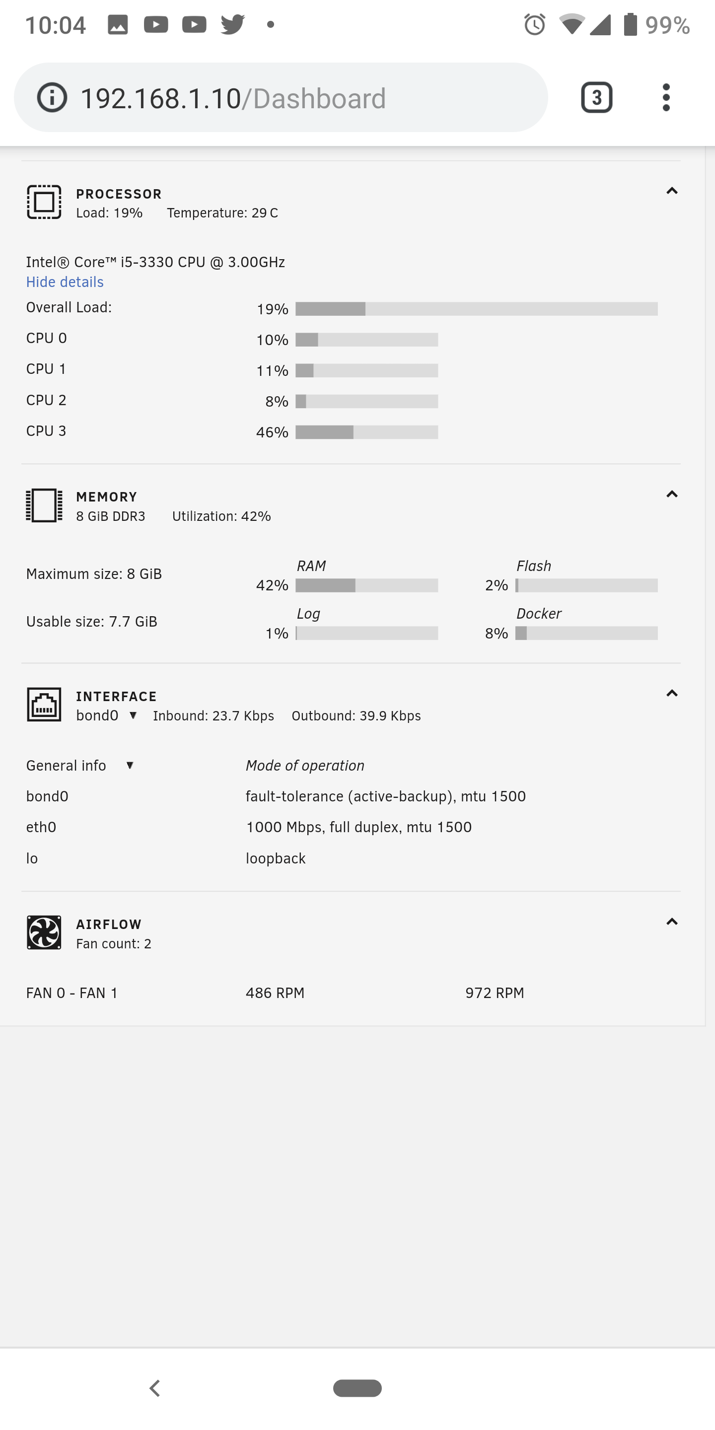

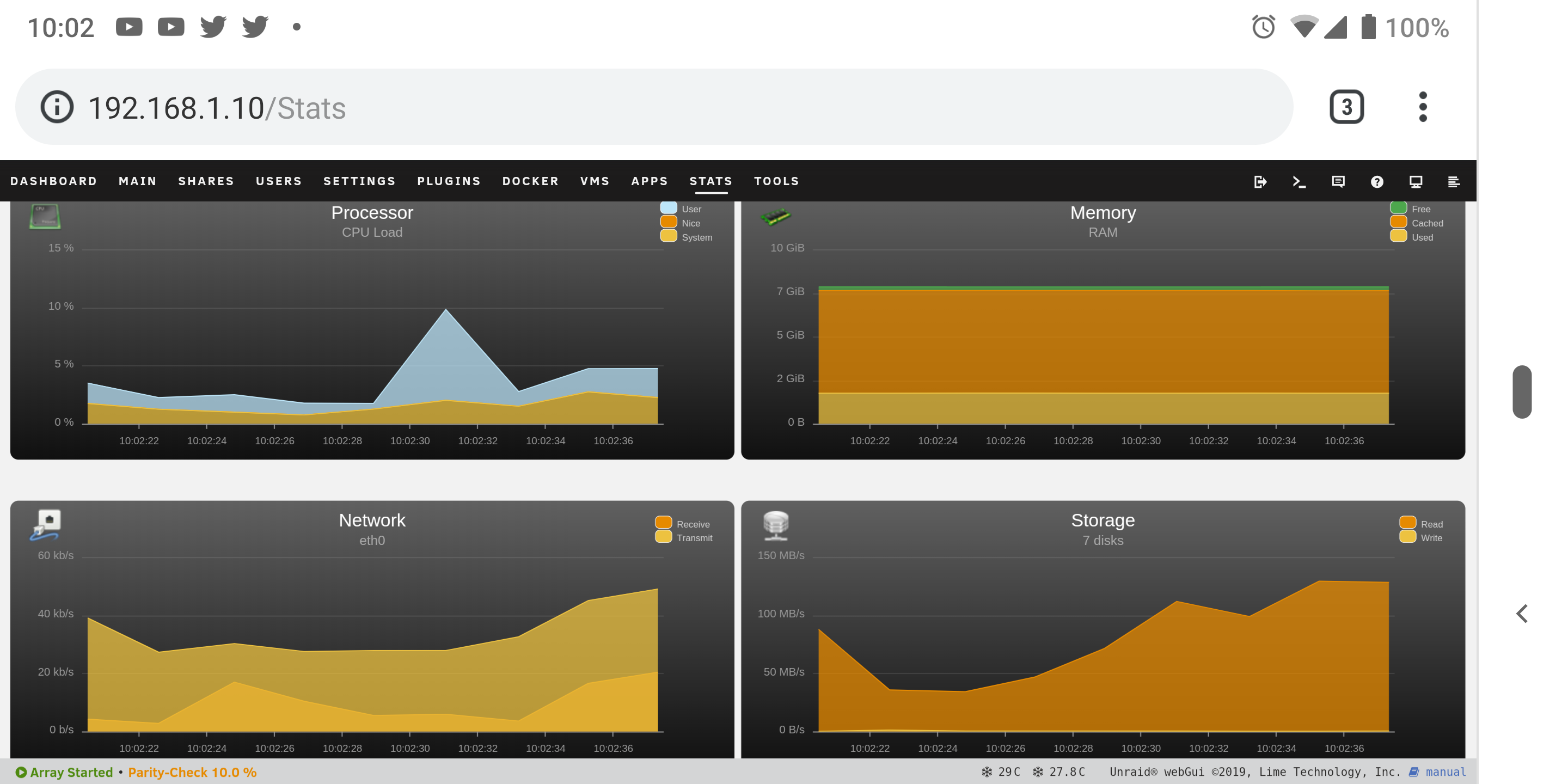

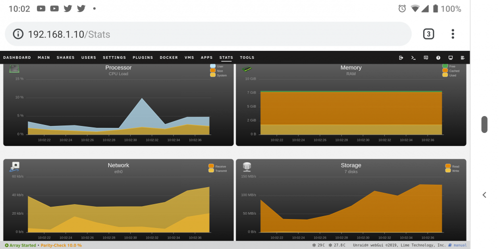

Hi all.
So I'm trying to track down why I have slow read write across my box when it comes to dockers and installed the Dynamix System Stats to find out more.
How ever looking at the status Vs the main page memory usage there seems to be a disparity.
On the stats page it looks like memory is 99% in use Vs main page 45%
Which is the best reading or is it the interpretation by me ?
Thanks
Terran

18 minutes ago, bonienl said:
Thanks... I guess I was expecting it to be consistent how ever you may have just pin pointed my problem.
If it's caching in to ram and I only have 8gb (Dell stopped you adding more in the bios) it would explain why windows on the same hardware worked different.
I'm thinking a cache drive with a swap file may help as I do not have one or would I still see the memory used ?
Thanks
Terran
Share this post
Link to post
Try the "Tips and Tweaks" plugin and lower the cache ratio percentages to 1% and 2% (instead of 10% and 20%).
This will help to reduce memory overload.

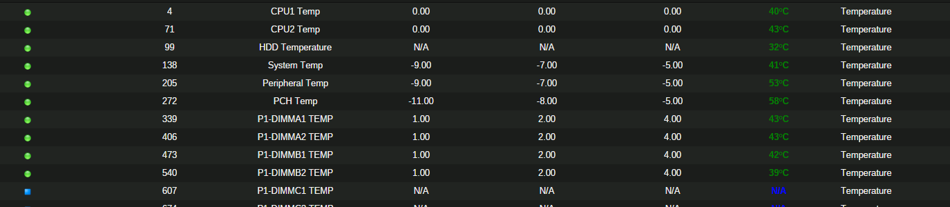

I am seeing the following on System Temps Plugin
But IPMI is showing motherboard is SM X9DR3
Also can you advise what to check for this log entries, doesnt happen all the time.
Feb 16 12:07:02 Test kernel: i801_smbus 0000:00:1f.3: Timeout waiting for interrupt!
Feb 16 12:07:02 Test kernel: i801_smbus 0000:00:1f.3: Transaction timeout
Feb 16 12:07:02 Test kernel: i801_smbus 0000:00:1f.3: Failed terminating the transaction
Feb 16 12:07:02 Test kernel: i801_smbus 0000:00:1f.3: SMBus is busy, can't use it!
