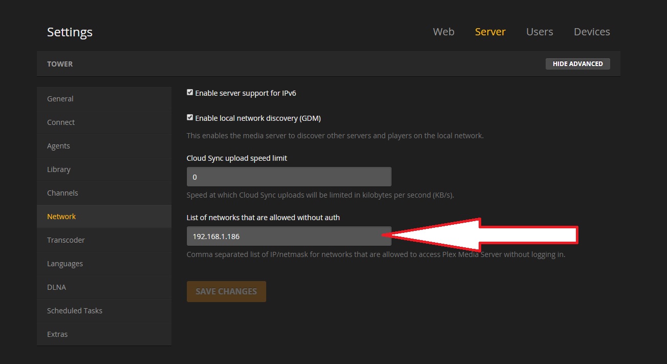

Found the fix more me..
Needo's plexwatch does run for me but didn't connect to plex after I installed Needo's latest update for plex.
This is how I fixed it..
In Plex got to seetings/server/network/
and add the IP of the unraid server to the  "List of networks that are allowered without auth"
I attached a picture as well.
Hope this works for you guys.
That will work until you enable Plex Home, at that point I think the only option is to put your username/password in the two config files.

I'm having similar problems.
My setup  using beta12
1) PhAzE plugin for Plex
2) needo's docker plugin.
I am running in bridge mode because I already have sabnzbd at port 8080 via a plugin - if I try to setup docker in host mode, it seems I lose the ability to spec the port mapping that I wish to use (8080 in the docker container, 8085 being "tried" at my host).  I recognize that this could be part of my difficulties - if there are any suggestions on how I might be able to use host mode, and not conflict w/ what's already mapped to 8080, please let me know and I'll give it a try.
No matter what I do, I continue to get Failed to access Plex Media Server.  I have changed the uname/pwd in both the config.php and config.pl  - I even logged-out and back in via Plex Servers page - which succeeded and verified that I'm using the correct uname/pwd :) .
tail'ing /var/log/apache2/error.log from a bash shell on the docker tells me:
[sat Jan 03 16:32:08.578744 2015] [mpm_prefork:notice] [pid 27] AH00169: caught SIGTERM, shutting down
AH00558: apache2: Could not reliably determine the server's fully qualified domain name, using 172.17.0.9. Set the 'ServerName' directive globally to suppress this message
[sat Jan 03 16:32:12.704235 2015] [mpm_prefork:notice] [pid 16] AH00163: Apache/2.4.7 (Ubuntu) PHP/5.5.9-1ubuntu4.5 configured -- resuming normal operations
[sat Jan 03 16:32:12.704262 2015] [core:notice] [pid 16] AH00094: Command line: '/usr/sbin/apache2 -D FOREGROUND'
[sat Jan 03 16:32:36.937849 2015] [:error] [pid 27] [client 192.168.1.20:59547] PHP Warning:  file_get_contents(http://localhost:32400/status/sessions?X-Plex-Token=): failed to open stream: Connection refused in /var/www/html/plexWatch/index.php on line 88
[sat Jan 03 16:32:36.938044 2015] [:error] [pid 27] [client 192.168.1.20:59547] PHP Warning:  simplexml_load_file(http://localhost:32400/library/sections): failed to open stream: Connection refused in /var/www/html/plexWatch/index.php on line 91
[sat Jan 03 16:32:36.938066 2015] [:error] [pid 27] [client 192.168.1.20:59547] PHP Warning:  simplexml_load_file(): I/O warning : failed to load external entity "http://localhost:32400/library/sections" in /var/www/html/plexWatch/index.php on line 91
I really want to embrace docker instead of plugin's - but don't want to start that transition with the apps that I use plugins for until/unless I can make something new work w/o a hitch.  So far....  sigh.
Thanks,
-Jim
If you have plex home enabled you need to make a small change to plexWatch config.php file
add the following line to the config.php file
$plexWatch['myPlexAuthToken'] = '';
then goto the plexWatch settings webpage, make sure you enter your username/password in the Plex Authentication section and then click save.
this should populate the extra line you put in the config.php file with your authtoken and plexWeb should have no problem connecting to plex
Hi scottc - thanks for the reply.
My config.php already has this field (empty = '') as downloaded.    But, I have some other oddities occurring when I try to save from the plexWatch settings page - I've removed/updated the container several times today and this recurs.
When I save from the plexWatch settings page, it seems the config.php gets corrupted and ends up looking like this:
<?php
require_once '/var/www/html/plexWatch/includes/functions.php';
$plexWatch['myPlexUser'] = '<my plex UserID here>';h.db';
?>lexWatch['chartsGrouping'] = 'no';'no';';zuywyDstNH';
So - I've been hand-editing the file w/ my userID/pwd.    Any other thoughts or ideas would be appreciated.
Also - even though my config.pl has $debug_logging = 1, I get no debug.log file produced in my plexWatch dir.
Thanks again, and regards,
-Jim
Another interesting piece of info...
If I intentionally use an incorrect or missing password in the plexWatch config page and press Save - I get a message telling me that
  "myPlex authentication failed"
If I correct the password, and press Save - then it tells me:
  "Settings saved"
So it appears as if all authentication to Plex succeeds just fine from the plexWatch configuration/settings page - it knows that it can access and authenticate with plex.    However, it still fails to permit me to see anything that's happened - always telling me:
    Failed to access Plex Media Server. Please check your settings.
from the plexWatch page.
Sorry jmaino,  Don't really know why your config file would be getting messed up like that.
