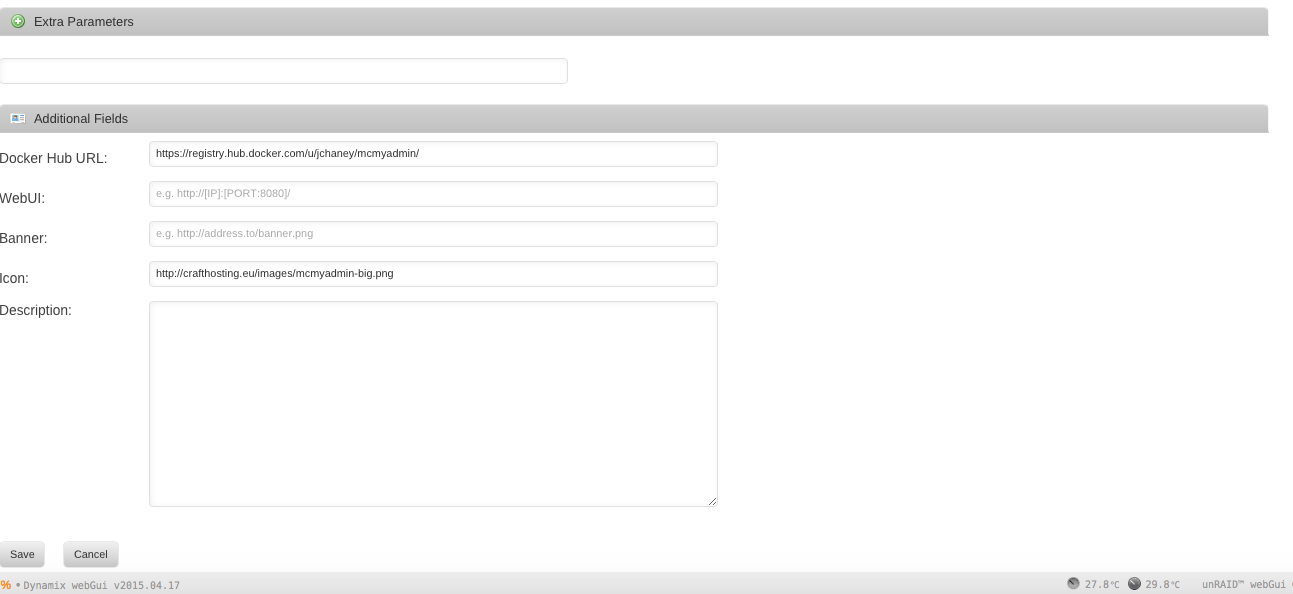

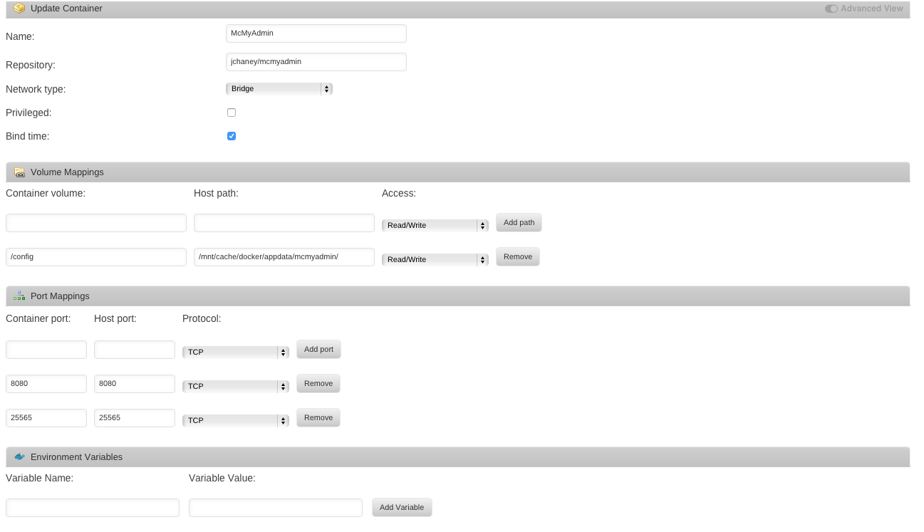

To get it going make a directory on your cache drive . e.g.. /mnt/cache/docker/appdata/mcmyadmin
Then goto the docker tab and click "Add Container"
Click on the Advanced tab on the top right of the docker field.
Fill in the following editing to your setup.
Click on "Create"
Access web at http://localhost:8080 (may have to use your server name or IP instead)
username and password for initial setup is : admin/pass123

I also noticed nothing is going in the folder I set for mcmyadmin. I set /config to /mnt/cache/appdata/mcmyadmin. Looking in that folder shows it is empty. Where are the Minecraft files going?
Did you use the extra settings to set password. Look at the variables available on the docker page listed in the first post.  I haven't tried this myself as I am in the middle of a parity check. I also need to change my port for unRAID web as it is set to 8080 currently and needed for this docker.
Maybe change the port mapping to /MCMA2_Linux_x86_64 instead of /config and see if files get saved there.
