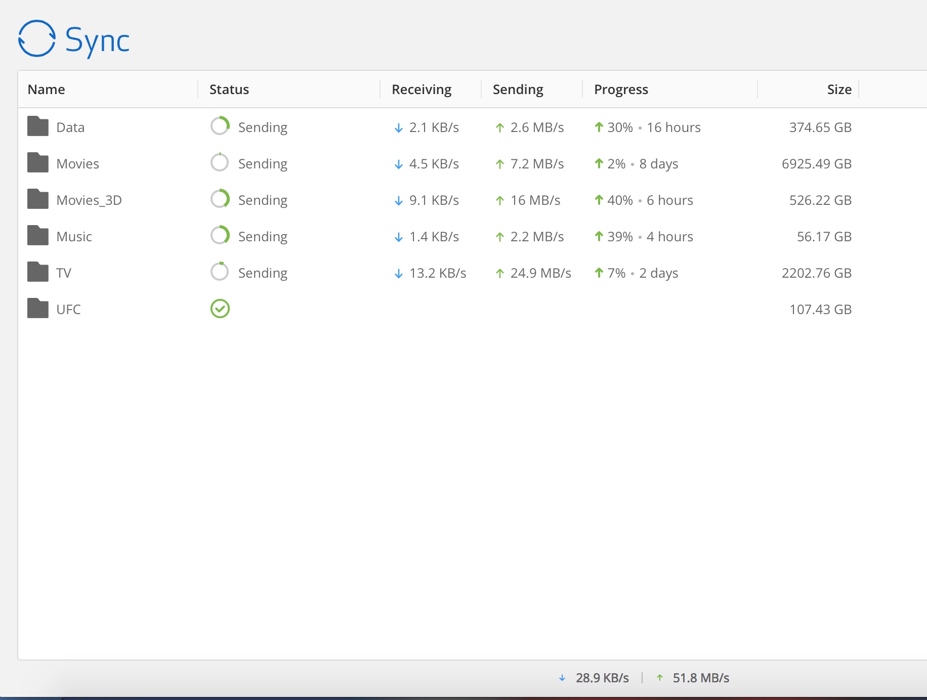

I have 2 Unraid Pro server.  1 consist of what is described in my signature, the 2nd one is only use to backup the 1st one using BT Sync.  The 2nd server is lower-spec (Core i3, 8GB RAM, SATA-2 onboard only) but i't still a server class Supermicro X9 board.  Both servers are connected at 1Gbps on a Netgear 24 Ports Manageable switch.
I'm actually get only around 51MB/sec transfert (around 410 Mbps) using BT Sync.  I'm just wondering if I should expect faster than that.
Both servers run the latest BT Sync Plugin (by Phaze) on Unraid 6b12.

Jay, both servers are on Local LAN.
In fact, I'm copying from 192.168.2.6 to 192.168.2.7 :)
I use BT Sync, but data do not travel to the Internet except maybe when I added the "share" in the BT Sync UI.
51MB/s is EXCELLENT for copying to a parity-protected array.  You're doing just fine  :)
Ok, thank you.  I expected it to be faster, but I guess it's all good.
Question:  When I copy to my main server, I got better speed because of my Cache SSD Drive ?  My backup server doesn't have a Cache disk.
