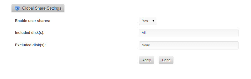

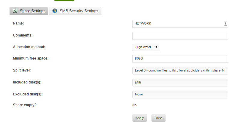

Show screenshots of the share settings.
And show a screen shot of the global share settings.

@Dgaschk / LionelHutz - Screenshots attached as requested.

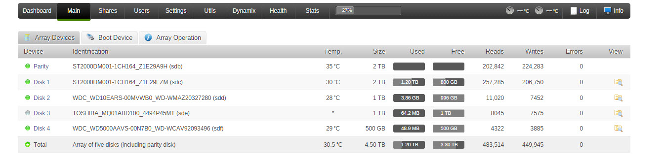

Show a screenshot of unRAID main. How are movies organized? The levels you indicate are 1 off, i.e., level one refers to the share.
Attached is the screenshot for Unraid main.

Once you hit 500GB free on disk one, files will start to be copied to disk 2.
@Earthworm - Disk1 is 2TB, and has already passed the halfway mark (1.2TB used) with my movie collection. Despite that, everything keeps going on that disk rather than being split onto the others.

I still don't understand your folder structure to recommend a split level. I can't make sense of your explanation so try a screen shot after expanding the Netshare share so the directories down multiple levels are shown.
I believe your split level is too high. I'm basing this on your claim that you manually created a directory you exclusively wanted on disk4 yet the server re-created it on disk1 during a write. The directory would not be created on another disk if the split level was set correctly.
