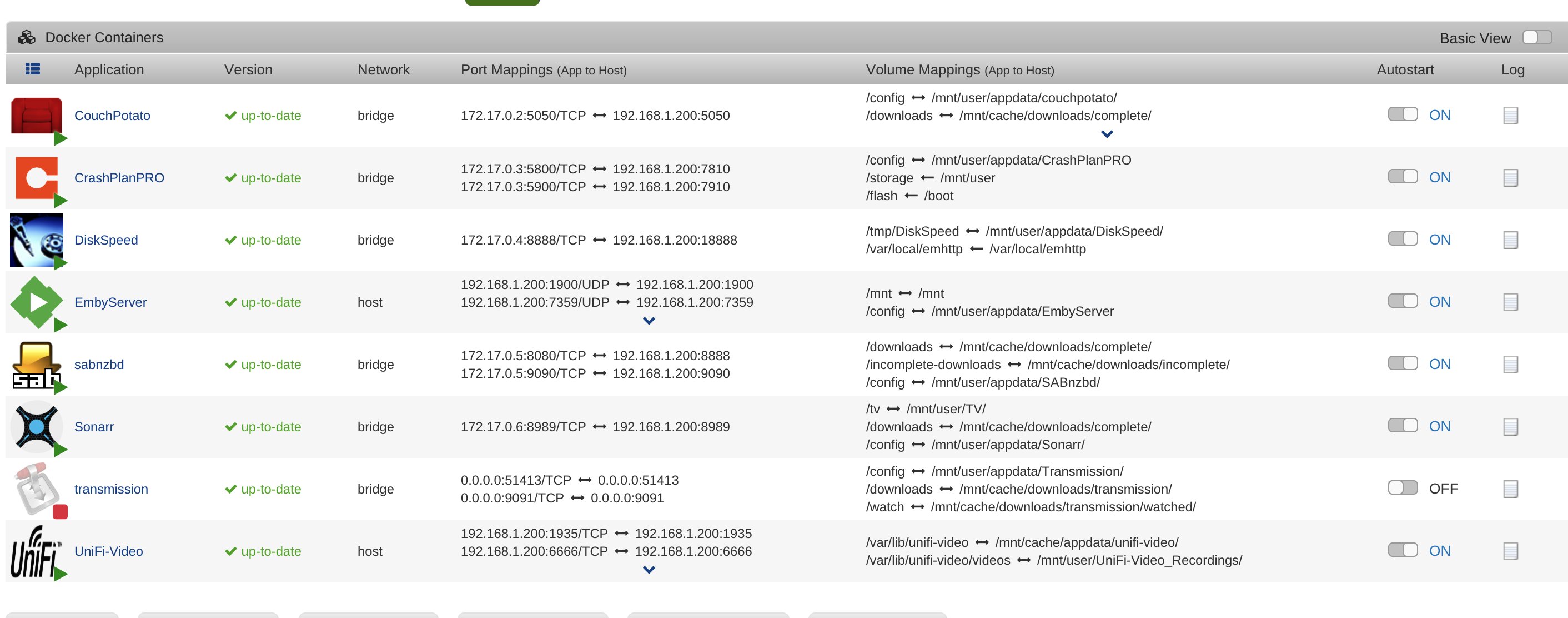

Hi...Yes, it would be great to know if this docker will be updated.  Thanks.
It is updated, do you not see the update?
Sorry to say no. It shows I am on 3.9.7 and on the Docker screen it reads it is Up To Date.
You know Docker containers don't update themselves, right? You need to `docker pull` them and restart, or what ever the work flow is in unRAID for doing that. Check out https://hub.docker.com/r/pducharme/unifi-video-controller/ where you can look at the Dockerfile and Build Details and see that it is up to date. My own personal instance is also 3.9.8, so I know it is working.
Good luck!
Hummm....I know when a my UnRAID see's there is an updated docker it tells me and I click on Update.  Thats all we need to do, we do not need to hunt for an update for once it hits the repository it tells us.  So not sure why this would be any different because this was installed from the repository. Therefore if there's an update, we were expected to show up as an update.  So not sure where it is or why we would not be alerted to update if the Docker package was updated.
Thanks

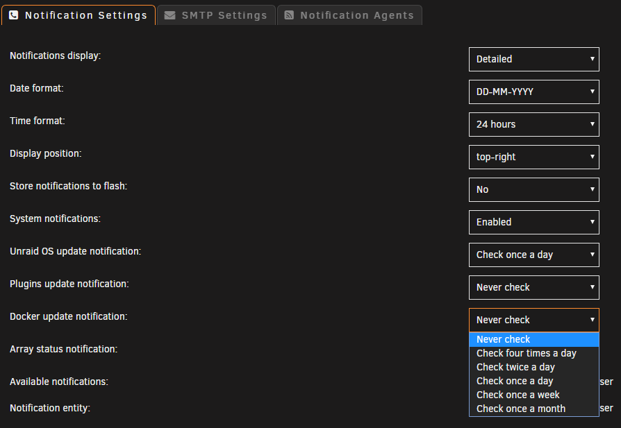

You do have to Check For Updates or have it do that on a schedule, or have CA AutoUpdate installed to install for you automatically.   It's not that "once it hits the repository"
Yes, it is active.  All my others will show Update and did so actually yesterday.  So I know it is working as it should be.
The interesting thing however, just as an FYI, I just pressed check for updates and it did find it.  So not sure how ofter they are checked, but until I press that, it did not show an update even though last night I had updates for the other dockers waiting.
Thanks
Assuming your other apps are from LSIO, they were actually updated August 31st.
Yup, it is set for one a week. So likely it was not updated yet when it last ran.  :)  But the docker update ran just fine, so all good good now.  Thanks guys!
