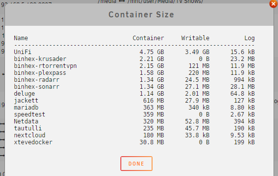

scubieman Posted November 28, 2018 Share Posted November 28, 2018 Is this right? Not sure why it needs 4.75 GB, or is it just a huge file? Quote Link to comment
