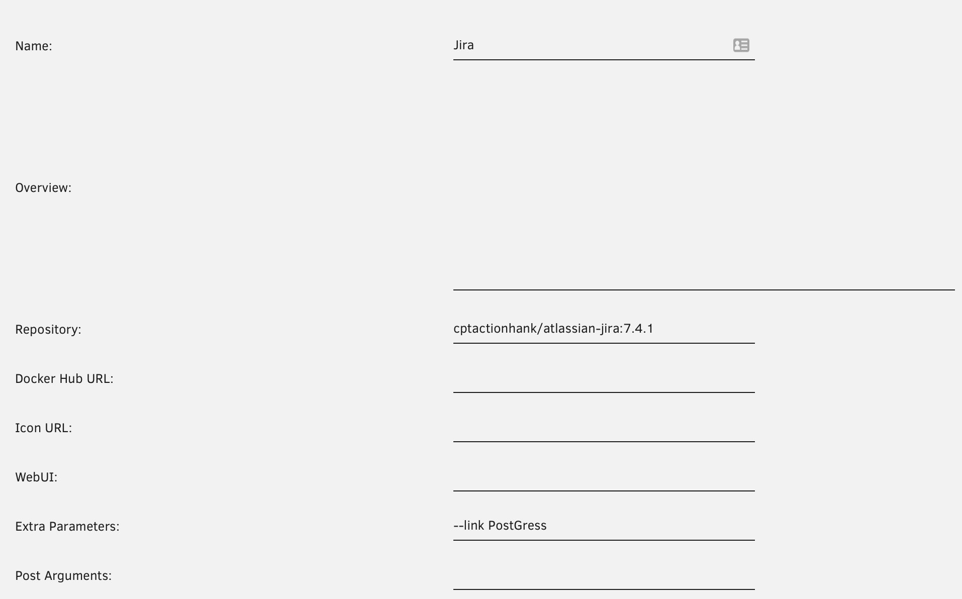

Not sure if this is still something that you need. I just found (Unraid 6.6.7) that if you select the 'advanced view' (change the toggle that normally says 'basic view' on the top right); you then have the option of 'Extra Parameters. This is where I was able to add the --link <container-name>.
965283270_ScreenShot2019-06-06at2_15_55pm.thumb.png.3106557ea2f91e54b0e25f8f8b4244d8.png
