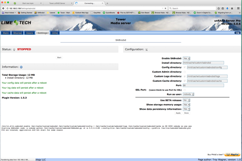

Just upgraded to version: 5.0.6 and have been successful installing couchpotato, sickbeard and Plex, but in trying to install sabnzbd I get an error saying that PID is not created and it will not start.
Initially it did start, but I made an error in the file path so I went to fix it and this is when the problem started. I have deleted all the files and started over from scratch and I am still not able to get it to work.
I believe I may have also tried to start it at one time on port 8080 which is already in use with another program, but I have changed it many times to try and use port 88 with no luck. I have also tried deleting everything again after that and starting over and I get the same issue each time.
I have attached a screen shot, showing the error and I can also post some of my log as well if required.

Ports 1-1024 are typically reserved for "known application" ports, things like ftp, http, and all those other protocols that the OSes use.  It's always best to use ports 1025+ to prevent problems.
For example, port 88 is usually:
TCP UDP Kerberos—authentication system
In some linux configurations, only root or similar privilege is allowed to use <1024 port numbers to listen.
