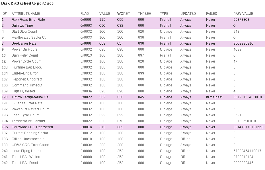

I have run short and long SMART scans and there appears to be only a single sector that might be problematic, but otherwise the drive is accessible and so is the content.  The SMART scans passed, but there were a few areas that were shown as warnings.

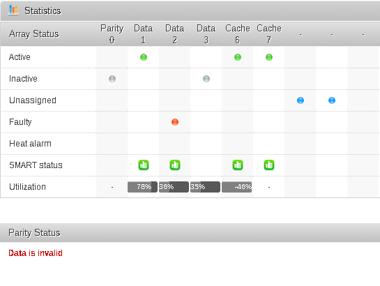

Post a screenshot of the main GUI page.
This what you're looking for?

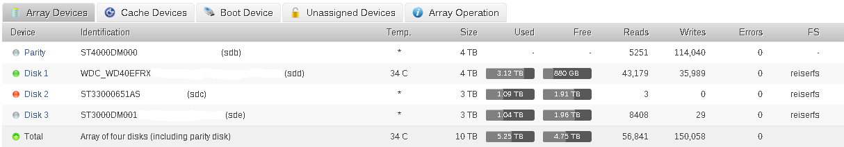

I do see a 'Disk 2' which I can browse...by definition does that mean I'm accessing the disk directly and it isn't being emulated?
No.
What does the main screen look like now? All other disks should be spun up if it is emulating the disk.
I presume the same as the screenshot I posted earlier, but I've got a new problem that emhttp appears to have tanked and I'm still running preclear...has anything been added for 6b12 to allow a more graceful restart of the web interface? (I've read the 5.x guides which appear to involve stopping the array among other things)
If the disk is showing as red-balled in the GUI and you can still access it via the user share then it is being emulated.  It sounds as if your parity might actually be good.  It could be shown as orange because it is being recalculated or something like that.

When you change out Disk 2, change the SATA data cable at the same time.  The SMART report show three 'UDMA CRC Error Count' errors.  These are errors where the data was read successfully from the drive but was corrupted by the time it reached the motherboard.  One source of this type of error is cheap SATA cables.  The other source is cross-talk between cables from tying the SATA cables together (to make a neat appearance).  You don't have a high number of errors but since you will already being working in there, you might as well address it now.
