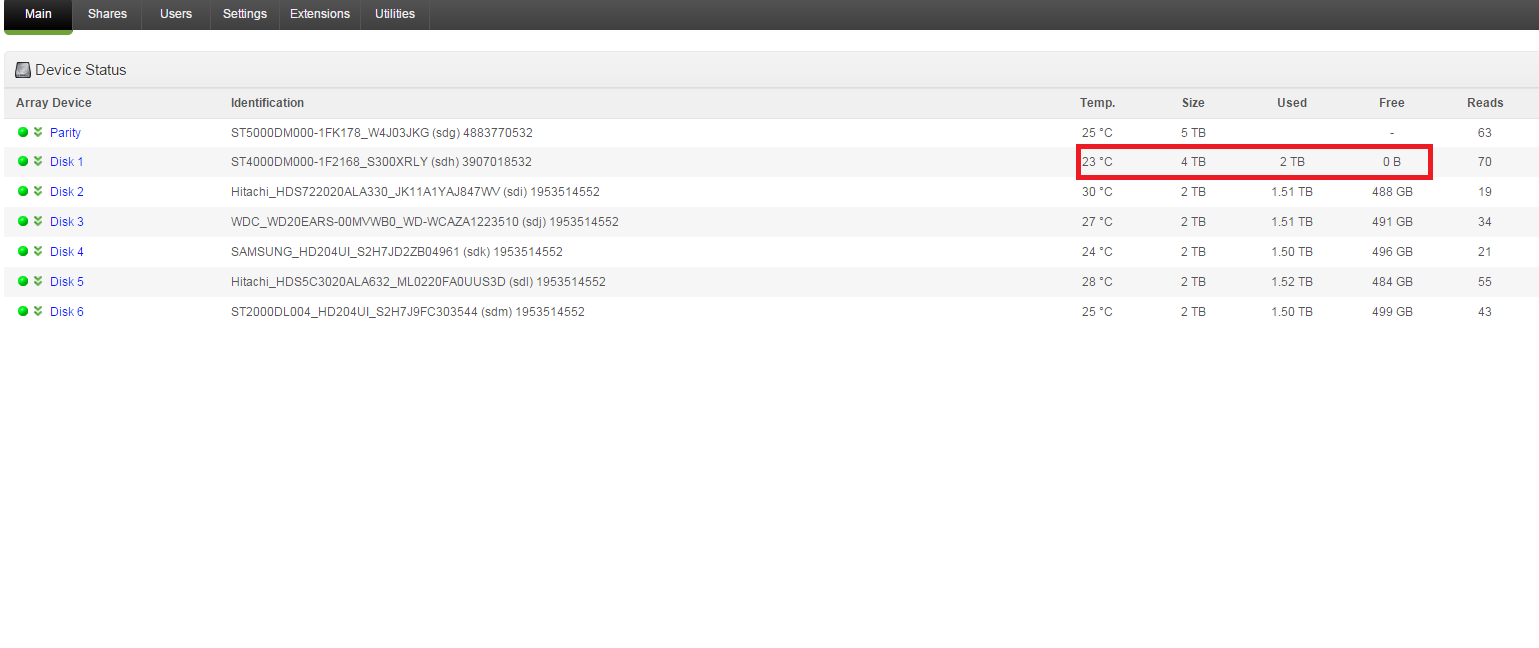

Hello,
I hoped some one can help me out. My disk1 2tb is ran out of space, all 100% use. Yesterday, I upgrade disk 1 to 4tb (Seagate disk). After success upgrade my disk 1 shows Size =4TB, use = 2TB, and Free = 0TB. That's reason when I do manual mover disk, the data in cache drive it doesn't flush all the data because of no space of disk 1 for them to move. I'm upgrade disks couple time, but this
time I have problem, Please help me out or give me a suggestion
Thanks in advance

Hello bjp999,
After issue command df /dev/md1  seem it does'nt solve problem , my unRAID system version 6.0 beta 7

Thanks you all to help me solve problem. Specially to RobJ point me to right direction to save my time and effort .
To solve this problem I have to upgrade to current version 6.0 beta 12 . After upgrade OS to 6.0.12  my unRAID works normal again, I can flush cache drive and moving files around. Next time if I want to upgrade, the first thing is upgrade OS to eliminate problem.
