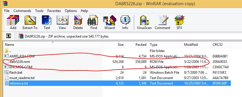

A little off-topic, but I noticed that it is reporting a BIOS from 2006!  That seems rather surprising to me.  The syslog does report a number of workarounds during the boot and setup.  It's possible that there would be better virtualization support in a newer BIOS, perhaps other benefits too.  However, I wouldn't attempt a BIOS upgrade without a safe way to restore what you currently have.

I am not sure there is a newer bios for the supermicro I have? I went to the website and downloaded the BIOS there and same date.. see attached photo.
