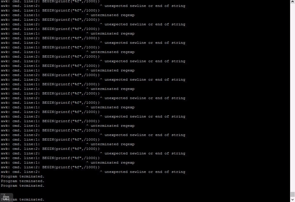

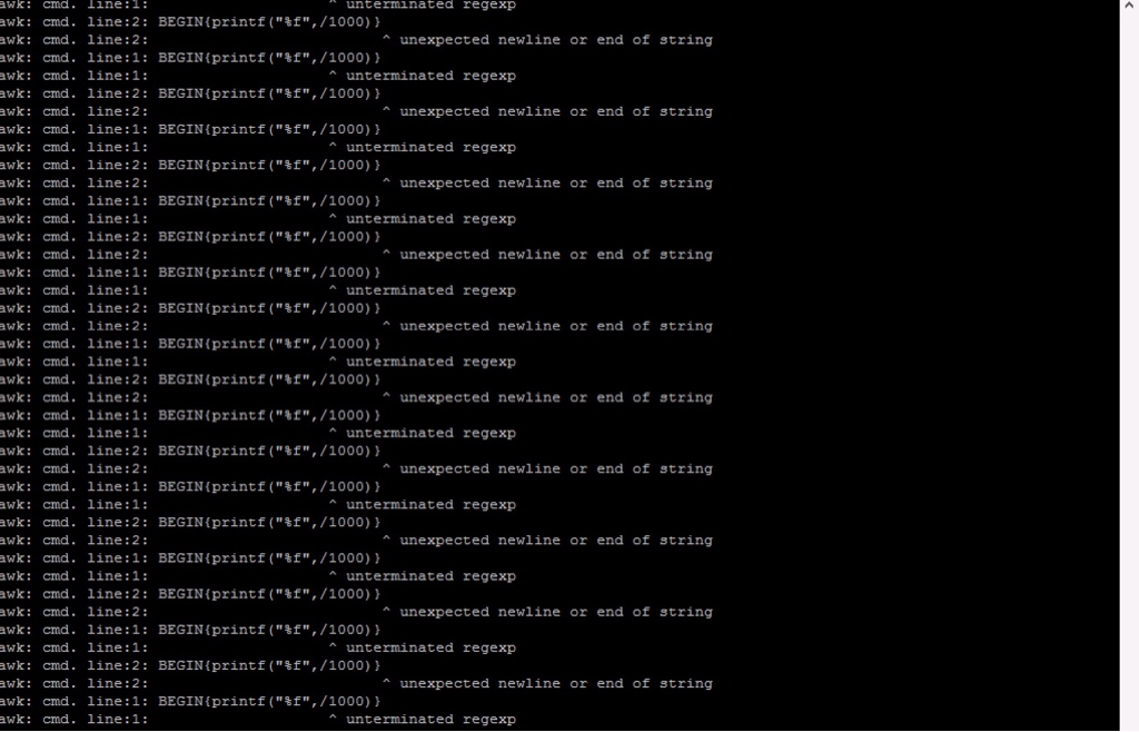

The bunker-daily script threw up a bunch of errors before I canceled it.
EDIT: I think I had a / at the end of the log path. I removed it and it appears to be running OK now.
