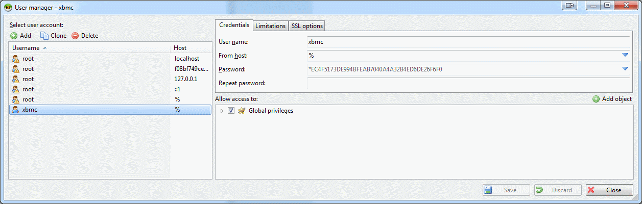

add a user to mariadb with full privileges (i don't use heidimysql so i don't really know what to tell you to do to achieve that)
make sure that username can be reached from all clients by using % in host, (you can lock it down with ip ranges later if you wish, but for now use %)

4. Connected to mariadb from windows, created user/pass as xbmc/xbmc with Global Rights (attached pic 1)

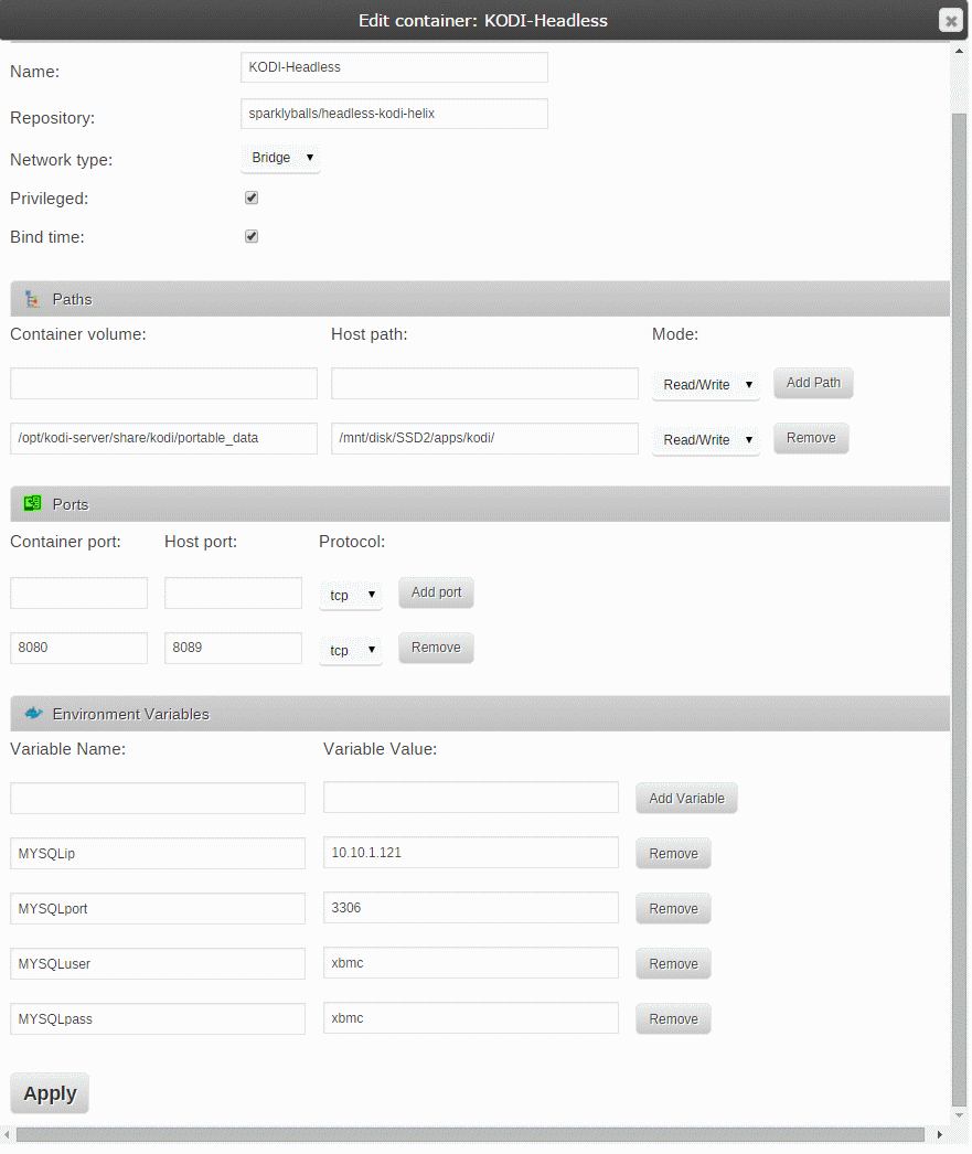

5. Started kodi with docker template settings (attached pic 2)

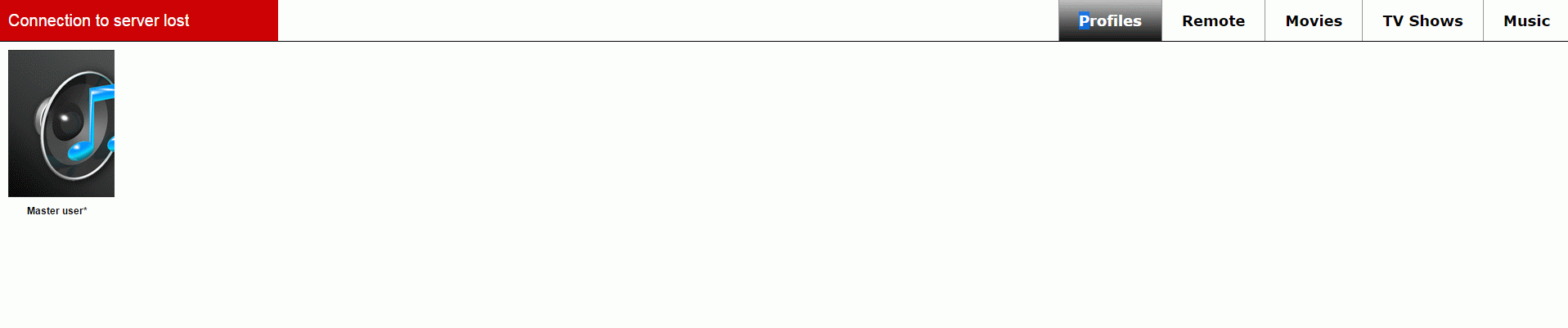

6. clicked on Profiles > master pass and got "Connection to server lost" (attached picture 3)

YOU'RE NOT MISSING ANYTHING, DON'T USE THE WEBUI, IT'S NOT MUCH USE.
my install is doing everything it should and i get that error clicking on the master profile thing.
there's not really much you can do with that webui at all. it's best just left well alone.
Oh okay, thanks Sparkly. I have been going round in circles since last night due to that connection lost message. Where do you pass the video library to be added? Any recommended link to help me configure the client gui? Thanks!
