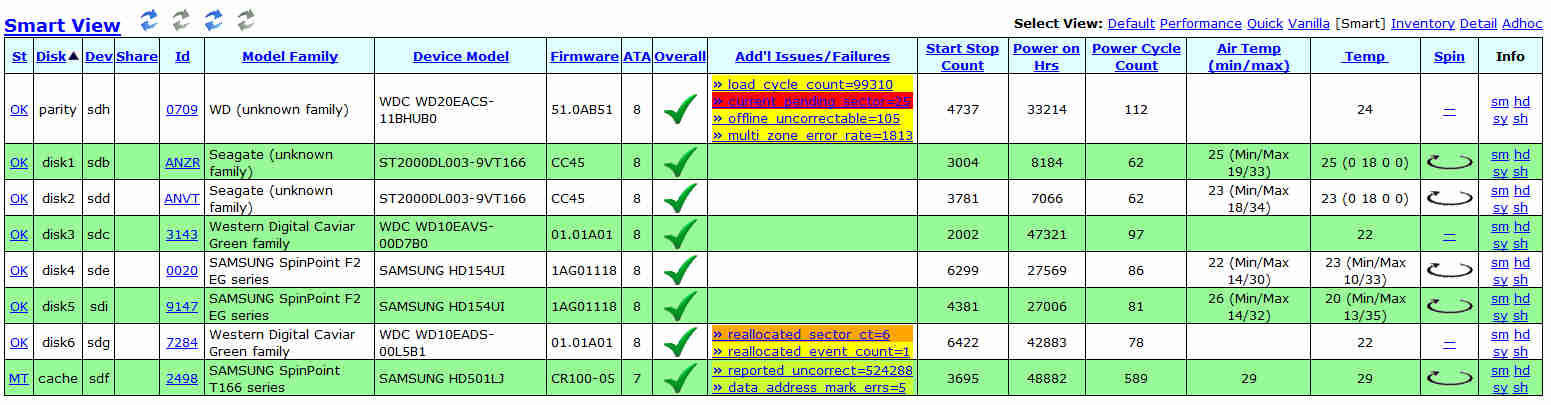

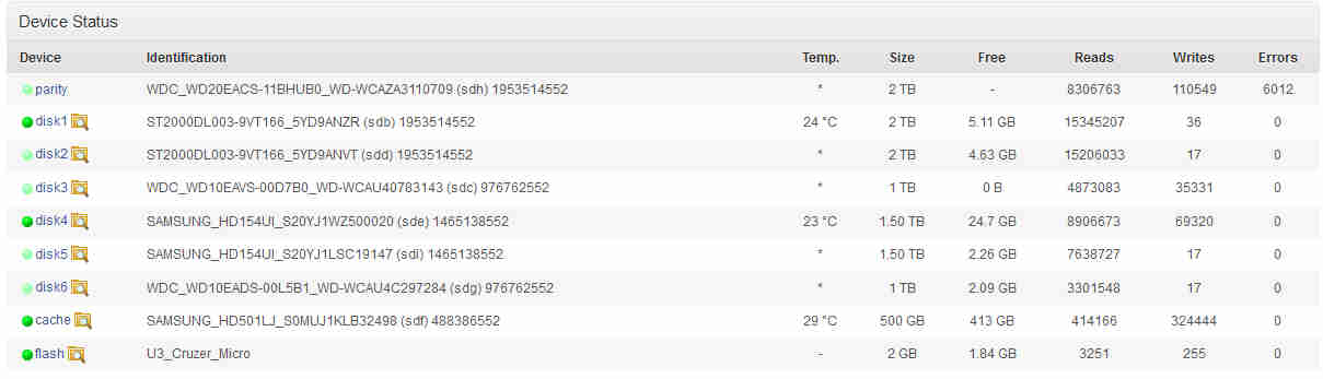

Hi - been using unraid 5.0-rc16c for a while with no issues - recently noticed the parity drive has errors according to the main page (see attached)
Ran the myMain smart view (see attached)  and the parity drive does have pending sectors. also see a potential issue with disk 6.
Should i replace the parity drive asap? What about disk 6?
any advice much appreciated
thanks,
inamak
I wouldn't trust parity with that many pending sectors.  You could always run a  preclear on the drive to try and get rid of the pending sectors, but with that many errors its probably only going to get worse sooner rather than later.
Disk 6 with 6 reallocated isn't a big concern right now, but you do want to keep an eye on it, and once it starts to grow you'd want to replace it.

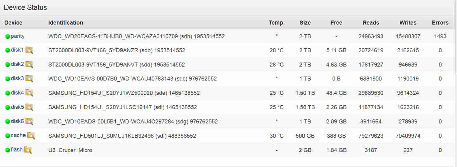

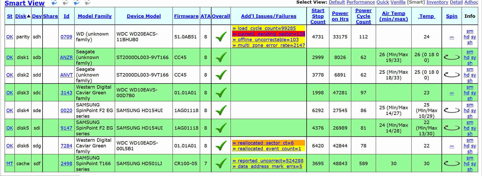

Ok so I did the correcting parity check - screenshots of the results attached.
For the parity disk, the errors reported on the unraid main page increased, but the smart report pending sectors decreased. I reckon I should change this based on this result even though the pending went down as it still has quite a few - opinions?
For disk6, the reallocated sectors has remained steady at 6, so I think I will just monitor that for now - right thing to do?

I tend to agree. I personally would keep running parity checks two more times and monitor disk 6. As I said before, I like 3 consecutive parity checks with the reallocation holding steady to trust a drive.
