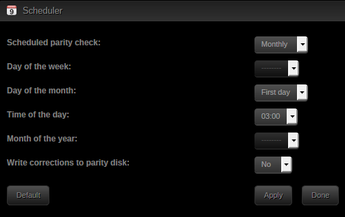

January 1, 201511 yr Same here actually Settings are Monthly First day 11am Write corrections No Though now that I think about it my server 'may' have been asleep at the time, not sure what it would've woken up new years day

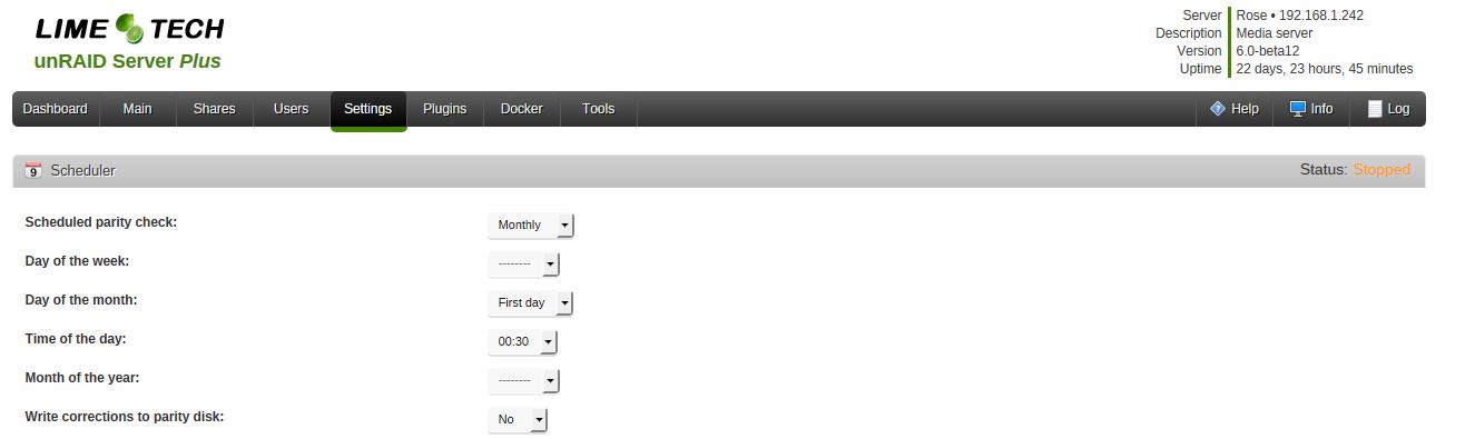

January 2, 201511 yr The parity check did not run on my server either. I did observe on the Scheduler page that the Status is flagged as 'Stopped'! See attached screen capture for details.
January 20, 201511 yr The parity check did not run on my server either. I did observe on the Scheduler page that the Status is flagged as 'Stopped'! See attached screen capture for details. With so many folks reporting this, clearly there is an issue. We will investigate. Stay tuned.
