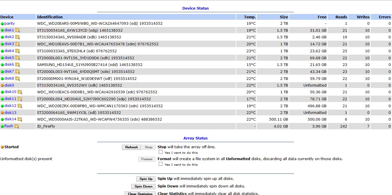

Disk9  was a trouble. ..i must  rebuild  the data  on it.
After  6  hours  i See the array  are  offline.  I look  and see  disk9  and disk13  are red  and unformatted.
And now  i don't  know  what  i can  do.

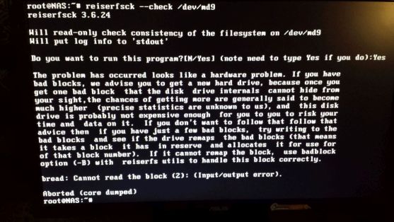

A disk can come up as unformatted if for any reason unRAID is unable to cleanly mount the disk.  This could be because a write failed at some point.
The recovery process is to:
  • Stop the array and restart it in maintenance mode
  • From a console/telnet session run a command of the form
      reiserfsck --check /dev/md9
    This can run for some time so make if using telnet make sure that the window is kept open while the reiserfsck is running.  At the end reiserfsck will report if any corruption is found and recommend a recovery action.
  • You probably now need to rerun reiserfsck with the recommended parameters for the recovery action.  You might want to check back here before taking the recovery action as taking the wrong recommended action may be non-recoverable
  • Repeat for each disk with issues.
  • Once recovery is complete you stop the array from maintenance mode and restart in normal mode and the disks should come up with their data intact

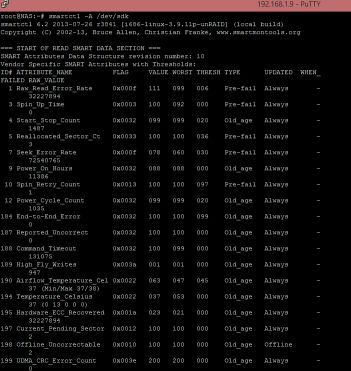

That suggest that there is a problem accessing that drive.    It may have dropped offline for some reason.  You could check by running a command from a console/telnet session of the form:
smartctl -A /dev/sdx
If the drive is online that should give you some results, and if not an error message.
If the drive is offline you might want to try rebooting the system and check that the drive is being seen at the BIOS level.  If not then there is no chance that unRAID will see it.  If a drive has dropped offline then rebooting can sometimes fix the issue.  If that does not bring it back then the drive may genuinely be faulty.  It can be worth checking the cabling as well in case one has worked loose.
ok...the two disks give a lot of results. (disk9 and disk13)

I notice that the screen shot of the SMART results showed there are pending sectors.    Not sure if these can cause the error message from reiserfsck.  I am not sure of the best way to recover from such issues but there are threads on this.

Post another screenshot so we can make sure we understand the current state of your array.
it's the same.....the two disks are marked as unformatted and when i klick format in unraid then aborted.

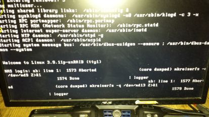

When you say the format is aborted, what do you mean? Is there a message that says that?
when i klick on format...ist starts..but after few second i klick on refresh and it don't format.
and when i have my tft on the server i see on it a massage with aborted
ok...
The syslog is showing I/O errors right at the start of the disk which is why it is not formatting.

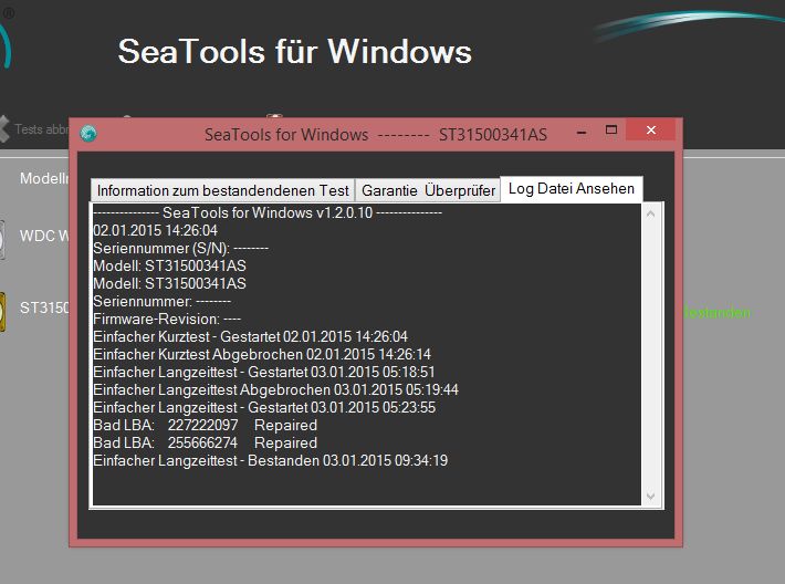

I would recommend connecting the disk to a Windows system and running the manufacturers diagnostic software against the disk to see what it says.
hmmm ok...i do it ...but under windows the disks works....and in the unraid not :-(
Just because a disk works under Windows does not mean that it has no faults.    That is why I said run the manufacturers diagnostic software to check out the disk.
done...for disk 9
now i test it in the unraid
>:( >:(>:( don't work....i don't can format the disk
