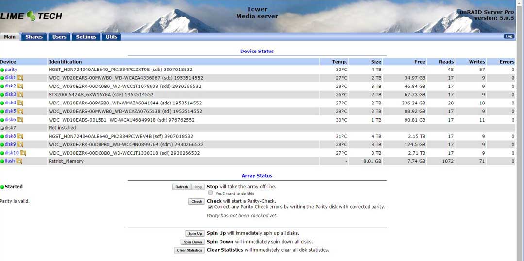

I have 3 1TB drives that I want to remove from my server.  I have read two different methods to do this and I am still confused as to the exact steps needed.
My current setup: Parity (3 TB) + 10 disks, 3 of which are 1 TB drives.  I want to copy the data from the 3 1 TB drives (disk6, disk7 and disk8) to an empty 3 TB drive (disk10) and then remove the 3 1 TB drives.
I have two user shares: "Videos" and "Backup1"

Maybe this will help you.  Below is the procedure I follow to remove a drive from my server without losing parity or access to my array for long periods of time.

1) Start the array
2) Empty the drive of all contents (move all files to another drive)
3) Telnet to the server
4) Unmount the drive to be removed with the following command (where ? is Unraid disc number)
  4.1) umount /dev/md?
4.1.1) If the command fails issue 'lsof /dev/md?' command to see which processes have a hold of the drive.  Stop these processes.
4.1.1) Some processes (i.e. smdb [samba file sharing]) require a restart to stop.
4.1.3) Try 'umount /dev/md?' again.
  4.1) At this point the drive will show 0 (zero) Free Space in the WEB GUI.
5) Write Zero's to the drive with the dd command.
  5.1) dd if=/dev/zero bs=2048k of=/dev/md?
5.1.1) Alternatively, you can put a progress bar on your dd operation by piping into the pv command
	5.1.1.1) dd if=/dev/zero bs=2048k | pv -s 4000G | dd of=/dev/md? bs=2048k
		5.1.1.1.1) The '4000G' in this example represents a target drive size of 4TB
  5.2) Wait for a very long time until the process is finished.
  5.3) when finished a report similar to the following will display in the console
	dd: writing `/dev/md?': No space left on device
	476935+0 records in
	476934+0 records out
	1000204853248 bytes (1.0 TB) copied, 48128.1 s, 20.8 MB/s
6) Stop the array
7) From the Devices tab, remove the device
  7.1) At this point the drive will show as 'Missing' on the Main tab.
 From the 'Tools' menu choose the 'New Config' option in the 'UnRAID OS' section.
  8.1) this is equivalent to issuing an 'initconfig' command in the console.
  8.2) This will rename super.dat to super.bak, effectively clearing array configuration.
  8.3) All drives will be unassigned
9) Reassign all drives to their original slots.  Leave the drive to be removed unassigned.
  9.1) At this point all drives will be BLUE and Unraid is waiting for you to press the Start Button.
    9.1.1) Assuming all is good, check the "Parity is valid" box and press the 'Start' button.
10) At this point, provided all is OK, all drives should be GREEN and a parity-check will start.
If everything does appear to be OK (0 Sync Errors) then parity-check can be cancelled.
11) Stop the array
12) Shut down the server
13) Remove the drive
14) Power up the server
15) Restart the array
16) Maybe a good idea to do complete a parity-check.

He is actually writing zeroes to the md? device, which means parity is also updated to reflect that. So, the drive is cleared and parity is effectively "cleared" of that drives data, so it can be removed and parity is still correct.
If you wish to keep the data intact on the removed drive, you will need to invalidate parity and recalculate from the remaining drives. This can be done with the "new config" setting, and you can remove multiple drives and put new drives in all at the same time, because you have to recalculate parity anyway.
When you do the new config, none of your original drives are assigned any more, so you must correctly reassign all the drives in their new slots. If you forget which drive is which and put a data drive into the parity slot, you will erase it. That's why you need to keep a record of which drive is assigned where by serial number when you do a new configuration. Manually issuing the initconfig command is no longer necessary for current releases.
Every root level folder on all your disks is automatically a share when you enable user shares. Inclusions, exclusions, split levels, permissions and such may have to be adjusted if you assign your drives to different slots. In your case if you make a note of all your current drives and assign them identically you shouldn't have to change anything, since you aren't changing disk4. After you are done copying the data and ready to reassign drives you could put the current slot 9 drive into slot 6 and slot 10 into slot 7 if you wanted so there wouldn't be any blank slots. Drive slots have no correlation to physical ports, they are just logical assignments. Some people choose to correlate them to physical positioning, but it's not necessary.

Epic. Thanks for posting, and thanks for coming back to update it. I added it to the Wiki lime-technology.com/wiki/index.php/Make_unRAID_Trust_the_Parity_Drive,_Avoid_Rebuilding_Parity_Unnecessarily
So, I did this procedure and copied all the data from a 1 TB drive (disk7) to one of my 3 TB drives, used the dd trick to write zeroes to the old drive, then selected "New config" etc.  Now this is my status: all disks are green except disk7 which is grey and "Identification" is "Not installed".  See picture below.  Question is: how do I get rid of the empty disk slot?  I.e, I want parity, disk1, disk2, ... disk9 to show in Device column.  I thought that the New Config would have done this?
When you did the New Config you should have assigned the old disk8 to disk7; the old disk9 to disk8; and the old disk10 to disk9.    You apparently assigned everything to the same slots they were in before ... so they still have the same designations.
It's perfectly okay to have unused slots in your assignments -- it's only a cosmetic issue to have the unused slots.
OK.  Can I do another "New Config" now and re-assign the disks?  Yeah, I know I'm a bit OCD (but probably not the only one around here).  Also, this step was not mentioned in the procedure description.
Sure -- just do a New Config and assign them to the slots you want.  Since you're changing NOTHING on the drives, you can "trust parity" as well  :)
OK.  Just to sure:
1. Stop array
2. Click on "Utils->NewConfig"
2. reassign the disk assigned to disk8 to disk7, the disk assigned to disk9 to disk8 and disk10 will have no assignment
3. click "Trust Parity"
Is this the right order?
Yes, but don't forget to assign the disk that's current #10 to #9  :)
Thanks I really appreciate it.
