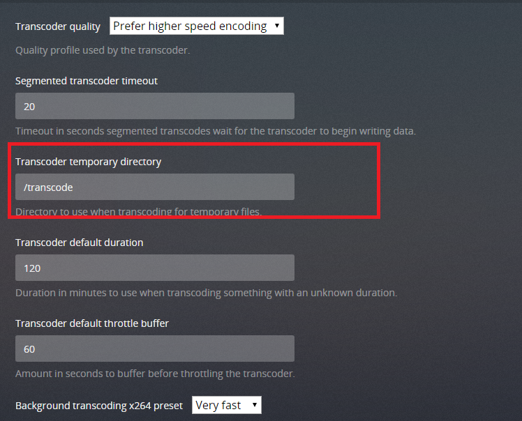

  • By this guide Plex uses your RAM while transcoding which prevents wearing out your SSD.   Edit the Plex Container and enable the "Advanced View":   Add this to "Extra Paramet
  • Yesterday, I was lazy and set only "/dev/shm/plextranscode" as my transcoding path. I checked the path and it was created: ls /dev/shm plextranscode/   But it stays empty while transcoding
  • Yes it is needed as /transcode will be created, even it is not mapped through the containers settings.   So I will hopefully update my guide for the last time ^^ EDIT: Done.

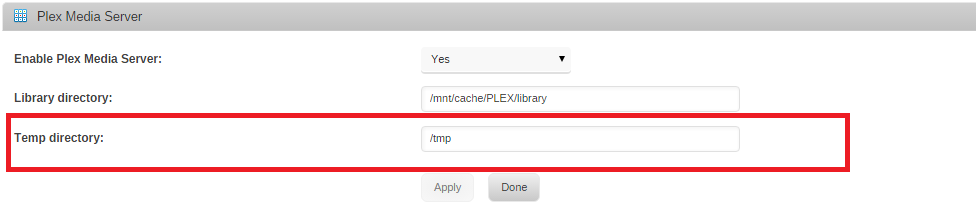

should my plex container look like this?
Temp directory = /transcode to /tmp
Edited by bombz
You are not running a container. You are using a plug in. What the OP said was to make a volume mount that maps /transcode on the container side to /tmp on the host side. But since you use a plugin it doesn't apply to you.
Simply put /tmp in the temp directory to use RAM as the temporary storage.
OK, right on!
You can say I am kind of not overly familiar with some aspect of this, I wanted to ask to clarify. I really appreciate the response, and hope to see how it works going forward. Going to change it up now.
Love the community. Thank you again (big time)!

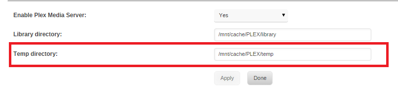

to reconfirm I posted my current changes below
Edited by bombz
Don't know how the plugin works, but you should most likely just add /tmp in the plex settings as it sees your filesystem directly. It's not like in docker containers where you have to map volumes for it to see the filesystem.
I have no idea actually what they mean with temp folder for the plugin. I'm not sure if they support the plugin anymore either.
Ah OK
I appreciate the heads up. Hopefully I am on the right path here, or at least have my settings correct (as above). Perhaps someone will fill in the gaps to the posted screenshots. Maybe in the PLEX settings, I set that to /tmp as well? Guess we shall see
23 minutes ago, bombz said:
Ah OK
Set the transcode path in the Plex settings to /tmp. I did say that in my previous post ;)
Already on it bother, I was more curious about the transcoder path within the plex app was all :-)
I'm talking about the plex app transcode path.
OK
Temp Directory = /tmp
Plex Transcoder DIR = /tmp
I shall see how she runs. Not sure how to confirm if it is using RAM, fingers crossed.
Thank you again
On 9/29/2017 at 11:52 AM, bombz said:
OK
Thank you again
Login to your unRAID box via ssh and then do a directory listing (ls) on the /tmp directory when you see a transcode happening on plex. You should see a randomized plex folder be created in the /tmp directory.
