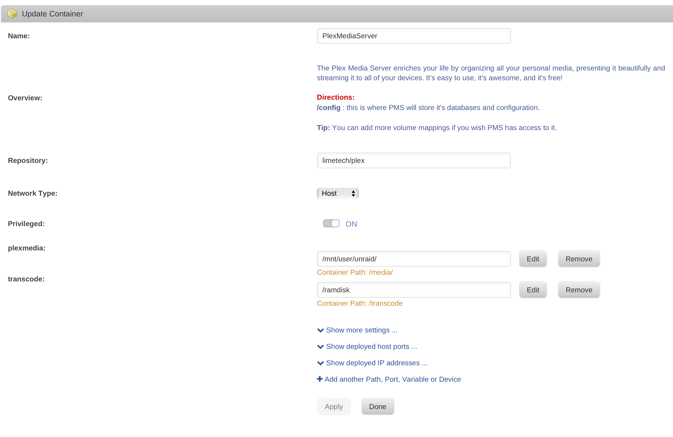

  • By this guide Plex uses your RAM while transcoding which prevents wearing out your SSD.   Edit the Plex Container and enable the "Advanced View":   Add this to "Extra Paramet
  • Yesterday, I was lazy and set only "/dev/shm/plextranscode" as my transcoding path. I checked the path and it was created: ls /dev/shm plextranscode/   But it stays empty while transcoding
  • Yes it is needed as /transcode will be created, even it is not mapped through the containers settings.   So I will hopefully update my guide for the last time ^^ EDIT: Done.
Under "Container Path" I added "/transcode" and under "Host Path", I added: "/tmp". Was that the right way to do it?

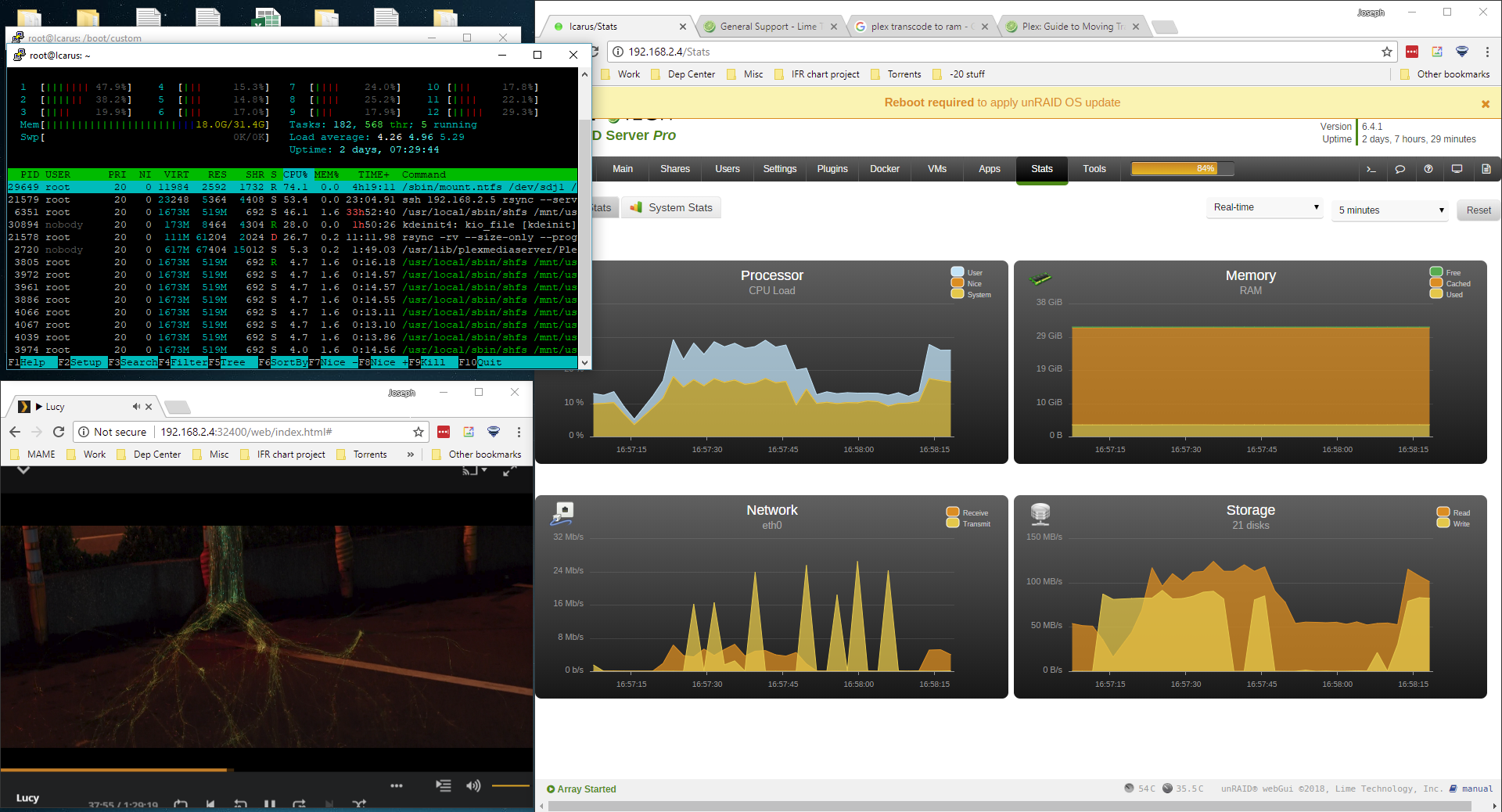

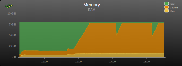

There doesn't seem to be a need to worry about memory consumption. The Plex/Unraid combo seems to handle itself just fine.
This is my box configured with RAM transcoding working on a 13 Mbps video over 2 hours with only 8 GB memory.
