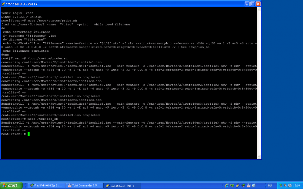

I wanted to just be able to drop .ISO files in a directory and queue up encoding. There is no queue in the CLI, but with my limited scripting knowledge I was able to piece together some scripts that almost work. I have a few small questions.
handbrake_queue.sh; ln 59
I would like the output file name to be the same as the ISO. My script is using the "basename" command and appending ".mp4". This produces "movie title.ISO.mp4". How can I remove the ".ISO"
handbrake_queue.sh; ln 16 - I'm trying to determine if any ISO files are in the directory. I can't seem to get this to work correctly.
if [ $(ls -l $ISO/*.ISO | wc -l) -gt 0 ]
I start "handbrake_queue.sh &" so it can just run in the background. Its a never ending loop with a 1min (will up this to 10min) delay between checks for new .ISO files. On line 74, I start /queuelist.sh & the same way to prevent the process outputting to the screen. Is this a good way to go about this?
Thanks
To get the name without the .ISO you need to supply an argument to the basename command, as I did in the short script I posted a few back in this thread.
The specific line in the script is
f=`basename $i .ISO`
Assuming "$i" has the full pathname to the .ISO file, "$f" will then have just the file name, without the .ISO suffix.
Joe L.
