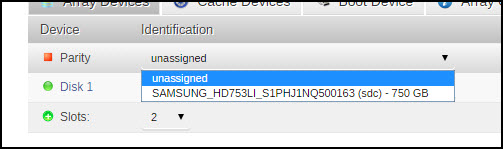

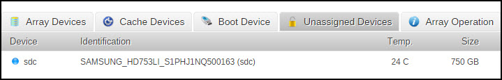

I can choose the disk, but when i start array it removes it (picture1). Then i have it under unassigned devices(picture2).

Error 22 occurred at disk power-on lifetime: 0 hours (0 days + 0 hours)
  When the command that caused the error occurred, the device was active or idle.
  After command completion occurred, registers were:
  ER ST SC SN CL CH DH
  40 51 00 2b 38 00 e0  Error: UNC at LBA = 0x0000382b = 14379
  Commands leading to the command that caused the error were:
  CR FR SC SN CL CH DH DC   Powered_Up_Time  Command/Feature_Name
  c8 00 60 20 38 00 e0 08   2d+01:53:35.380  READ DMA
  ef 10 02 00 00 00 a0 08   2d+01:53:35.380  SET FEATURES [Enable SATA feature]
  ec 00 00 00 00 00 a0 08   2d+01:53:35.370  IDENTIFY DEVICE
  ef 03 46 00 00 00 a0 08   2d+01:53:35.370  SET FEATURES [set transfer mode]
  ef 10 02 00 00 00 a0 08   2d+01:53:35.370  SET FEATURES [Enable SATA feature]
Error 21 occurred at disk power-on lifetime: 0 hours (0 days + 0 hours)
  c8 00 60 20 38 00 e0 08   2d+01:53:32.930  READ DMA
  ef 10 02 00 00 00 a0 08   2d+01:53:32.920  SET FEATURES [Enable SATA feature]
  ec 00 00 00 00 00 a0 08   2d+01:53:32.920  IDENTIFY DEVICE
  ef 03 46 00 00 00 a0 08   2d+01:53:32.920  SET FEATURES [set transfer mode]
SMART Self-test log structure revision number 0
Warning: ATA Specification requires self-test log structure revision number = 1
No self-tests have been logged.  [To run self-tests, use: smartctl -t]
SMART Selective self-test log data structure revision number 0
Note: revision number not 1 implies that no selective self-test has ever been run
SPAN  MIN_LBA  MAX_LBA  CURRENT_TEST_STATUS
    1        0        0  Not_testing
    2        0        0  Not_testing
    3        0        0  Not_testing
    4        0        0  Not_testing
    5        0        0  Not_testing
Selective self-test flags (0x0):
  After scanning selected spans, do NOT read-scan remainder of disk.
If Selective self-test is pending on power-up, resume after 0 minute delay.

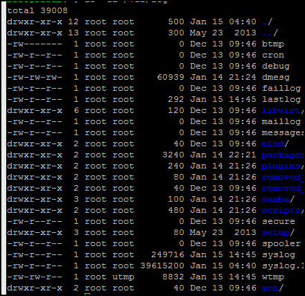

Post a complete syslog
In my syslog which i got with (cp /var/log/syslog /boot/syslog.txt), there are only logs from transmission now like this:
 Jan 15 05:14:23 Tower transmission-daemon[22014]: Nodi.Reši.Boži?.2004.SLOSiNH.x264 Could not connect to tracker (announcer.c:999)
The log must have rotated. What do you get with
ls -al /var/log
Get syslog.1 with
cp /var/log/syslog.1 /boot/syslog.txt
Zip and post
Run a preclear on it and if it passes try to add it again.
I see from your post history that you are building a new server, so maybe you already have another drive ready to go. If so you could just put that in as parity, then see if you can get this one precleared.
Till now my parity was dead. Yesterday i upgraded to the lastest beta version and it started to work again. So strange but thumbs up anyway  :D
