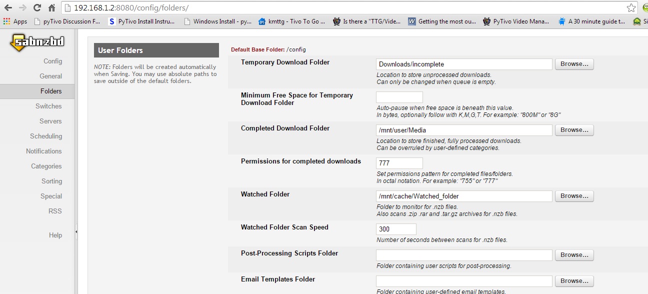

I cannot configure sab to write to a usershare on my array. (see attached screencaptures)
The docker is installed on a 'cache only' user share but cant write to the \mnt\user.  Sab is generating a "Post processing error. Cannot create final folder /mnt/user/Media/movies_temp/"

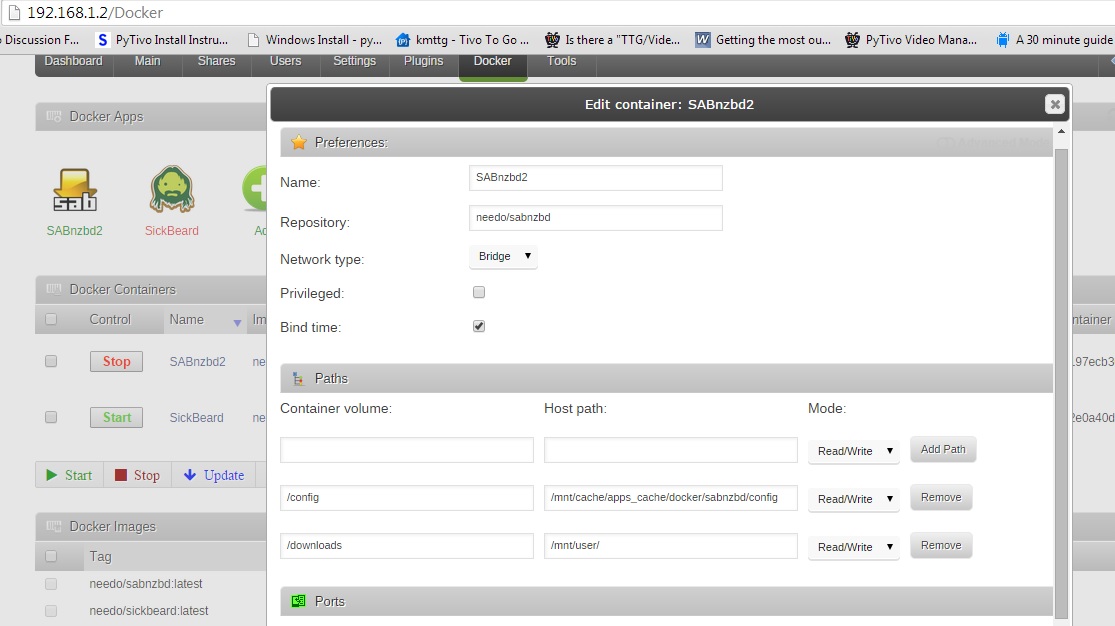

You have told the container that you want it to refer to /mnt/user as /downloads. So in the app, instead of /mnt/user you should instead say /downloads.
You have your Temporary Download Folder as /config/Downloads/incomplete. So with the way you have /config defined that will be /mnt/cache/apps_cache/docker/sabnzbd/config/Downloads/incomplete in unRAID. That is OK if you want it to go to your cache drive.
Also, you say docker is installed on a cache-only share, but it is not clear what is meant by this. Do you mean the docker.img file itself?
In any case, your apps_cache share should be set to cache-only if it isn't already.
Great!  Will re-configure my folders.  And yes the *.img is on a cache only share and the app_cache share is cache only.
Thanks
I hadn't realized that the container volume sections were defining the associated paths in the array.
