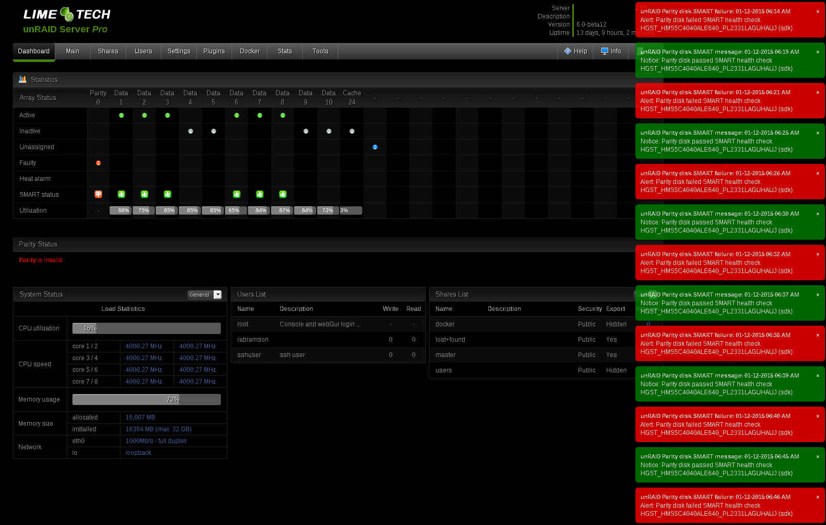

Parity drive "device disabled"
Woke up this morning to find that my Parity drive has been disabled.  I have attached a screen shot

How did you get this syslog? I'm pretty sure stopping the array as you said you did should result in syslog entries.
How did you determine the drive was disabled around 614 this morning?
I putty'ed into the system and
cat /var/log/syslog
On the image I posted the first box on the right sees 6:14am.  Also I have the notifications setup and I received an e-mail at:615am saying
Event: unRAID Parity disk SMART failure
Subject: Alert: Parity disk failed SMART health check
Description: HGST_HMS5C4040ALE640_PL2331LAGUHAUJ (sdk)
Importance: alert
Well, the usual advise is to replace the drive, and then see if you can get the old drive to pass a preclear before you try to use it again. I was just trying to make sure you didn't have a loose connection or something.
I was thinkinthe same thing that a connector might not be connected properly.  I will get another drive and see what I can do. when I get home and am able to physicaly look at the machine.
I really appricate all the help as always everyone here is very helpful.
Thank you
