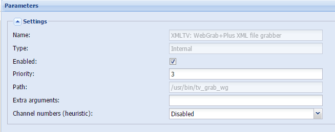

thank you!! mayby you can heb me with te following error :
2016-09-21 10:07:02.000 xmltv: /usr/bin/tv_grab_wg: grab /usr/bin/tv_grab_wg
2016-09-21 10:07:02.001 spawn: Executing "/usr/bin/tv_grab_wg"
2016-09-21 10:07:02.016 spawn: cat: can't open '/config/data/*.xml': No such file or directory
The guide.xml is in the following directory :
/mnt/cache/appdata/tvheadend/config/data/guide.xml
I'll see if I manage to update it in the near future.
I see that you have modified the location of the xml. That is not how I set it up.
You have modified the tv_grab_wg file and it looks like the path is correct. But you have used the * or it says guide.xml in the file? If it says *, exchange it to guide.xml and try again.

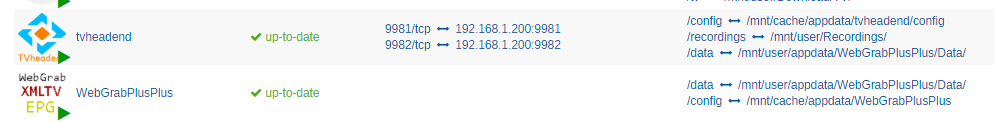

You are not using "my" version of tvheadend, but  linuxserver's version, so it's now a little bit clearer.
Change the data mapping of webgrab++ to the same as the tvheadend config but add data at the end. For you it will be like this:
/mnt/cache/appdata/tvheadend/data
Changed the path , but still the same error.
I tested tobbenb's Docker version an  then its works , so i think the problem is in the linuxserver docker.
What is the output of the below command.
ls -la /mnt/cache/appdata/tvheadend/data
output is  :
drwxrwxrwx  2 nobody users     23 Sep 22 13:04 ./
drwxrwxrwx 13 nobody users    194 Sep 22 09:40 ../
-rw-r--r--  1 nobody users 166632 Sep 22 13:04 guide.xml
output is  :
I found the problem. It's the * in tv_grab_wg in the xml file path. It works when doing cat as a standalone command, but fails in the script. I'll push an update soon to fix it in the tvheadend version (Linuxserver).
