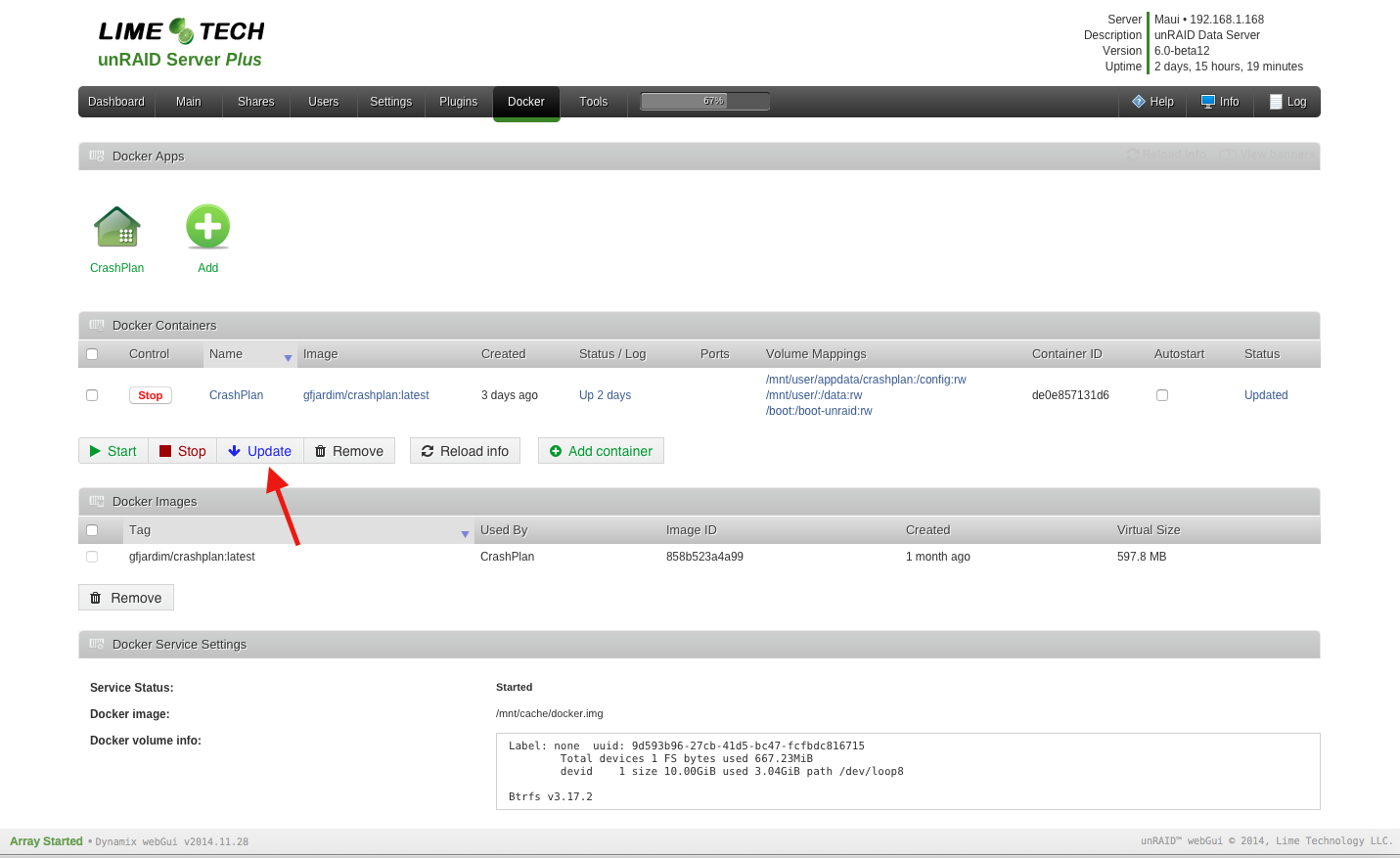

I'm sorry if this is a basic question -- to update my docker app to the newest version, do I simply click the "update" button? Should I first "Stop" the docker app, then click the "Update" button, then click "Start" to restart?
Thanks for this great docker app!
UPDATE:
Yes, I just stopped the docker, clicked "update" and then the docker restarted on it's own. All is working well!
