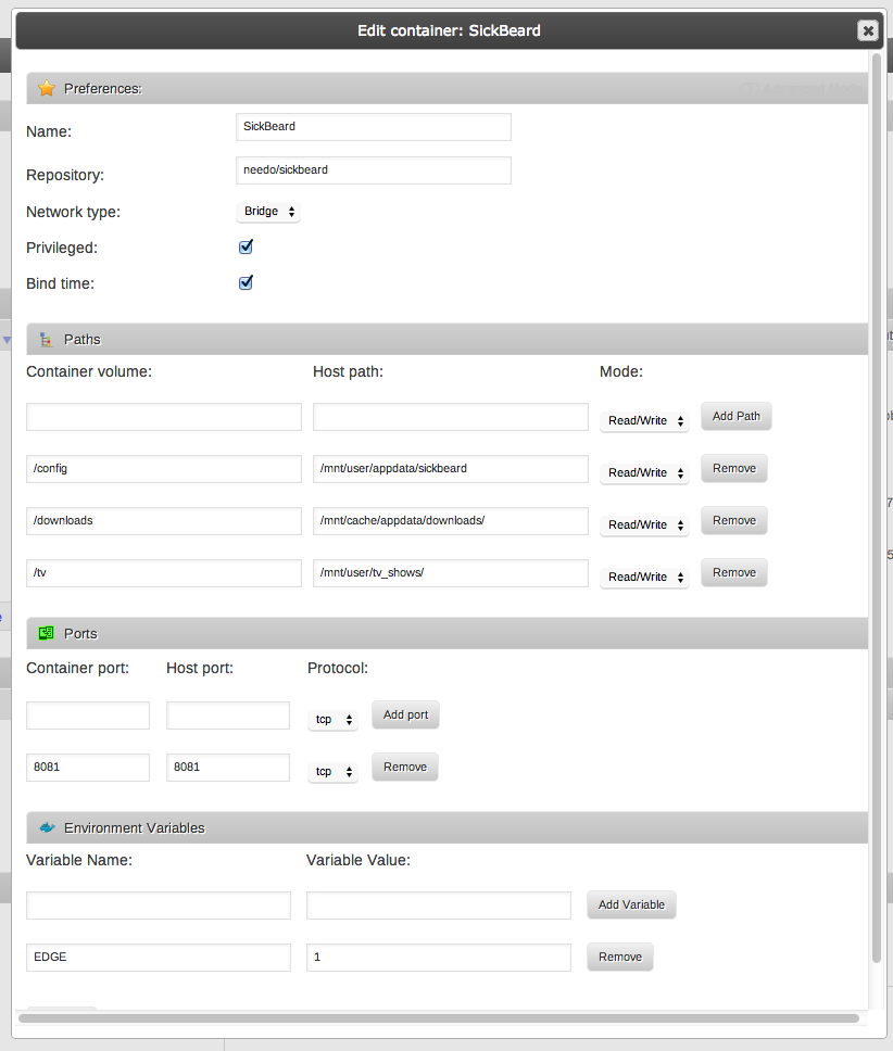

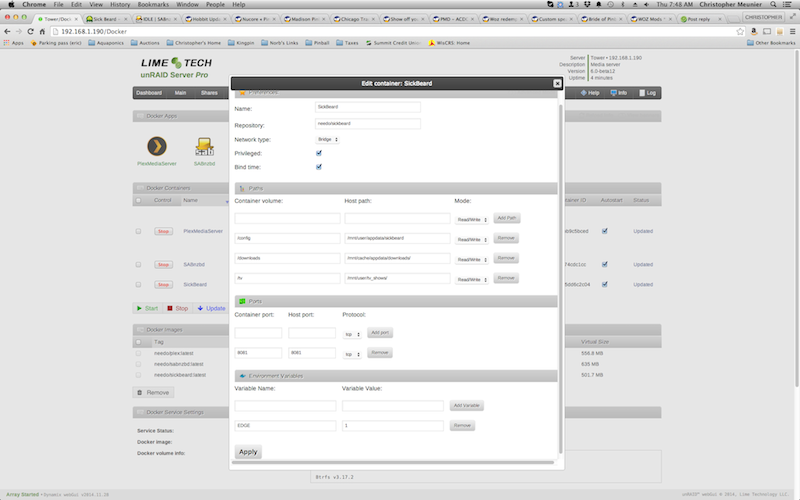

i have also attached a screen shot of my sickbeard docker setup.
can you get that in a better resolution, or if you have to in two screens.
there's no way i can read that, and if i blow it up the text just becomes blocky and garbled.
Off to work already, will try again tomorrow morning.  Thanks for looking.

yes, provide a better screenshot of your docker config, and a screenshot of the sickbeard config (espically the part about WHERE its moving your files TO)

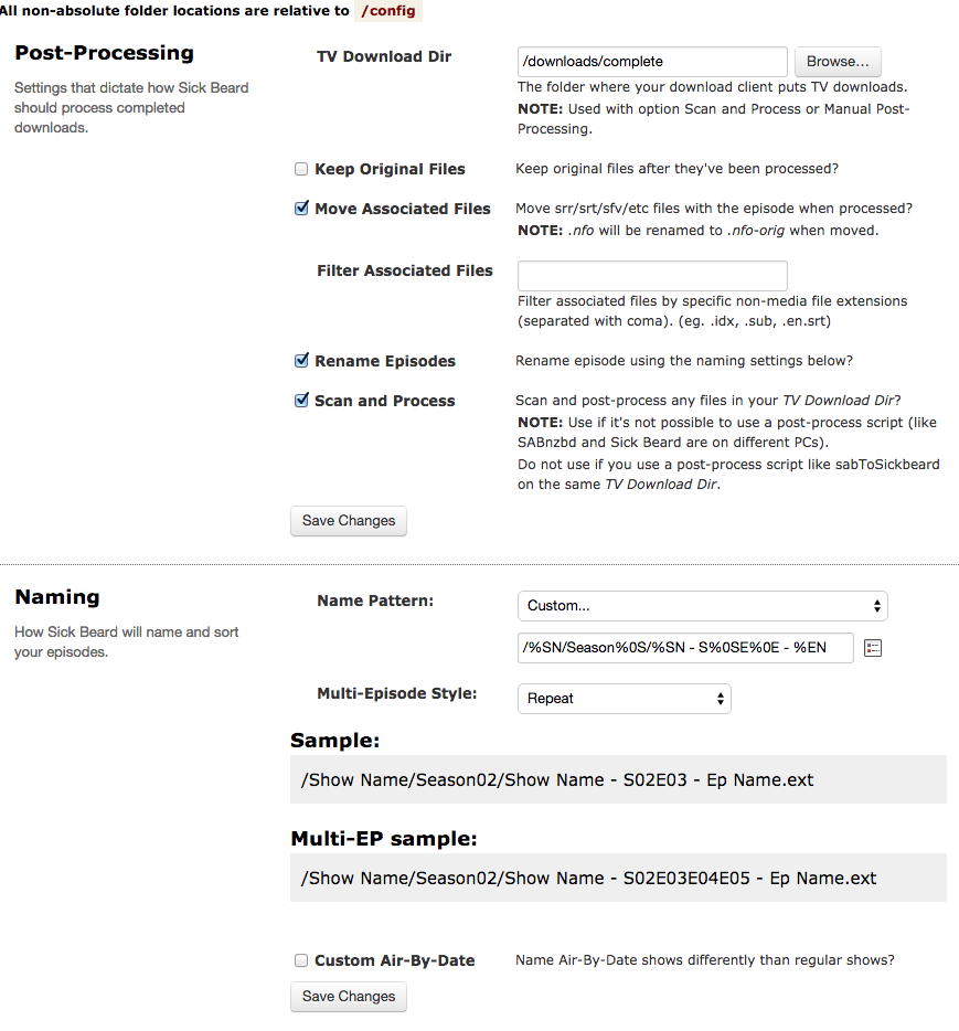

here is the docker for sickbeard
here is the sickbeard post process config
it's this screen we need to see, it is where your tv shows get saved to.
the screen you captured there is where your downloader puts the file for sickbeard to move.

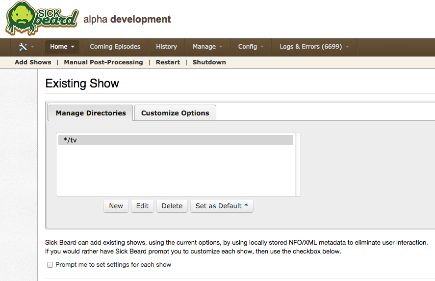

this is what i have
sickbeard can see my shows, but it can't seem to write to the folders
also, i do not understand why it is try to create a folder. the folder is already there.
