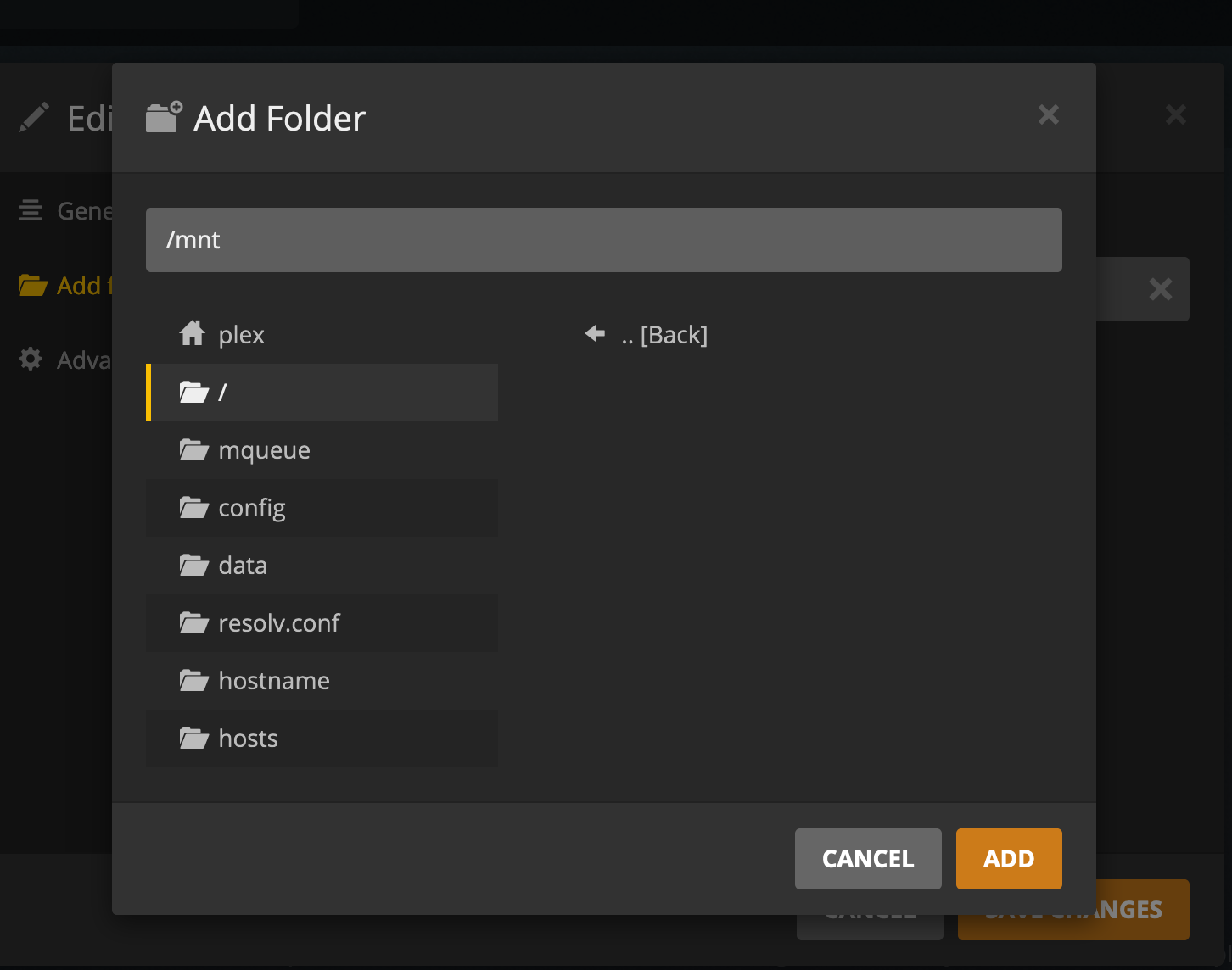

new to docker, can't find my media files in plex
ok so I am new to docker and I got a plex container installed and when I try to point plex to where my media files are but I can't get past /mnt/
so in comparison, I have the plex server plugin installed and it works fine, I point it to /mnt/user/Media/TV but in the plex server installed through docker it shows nothing in /mnt/

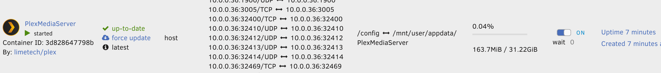

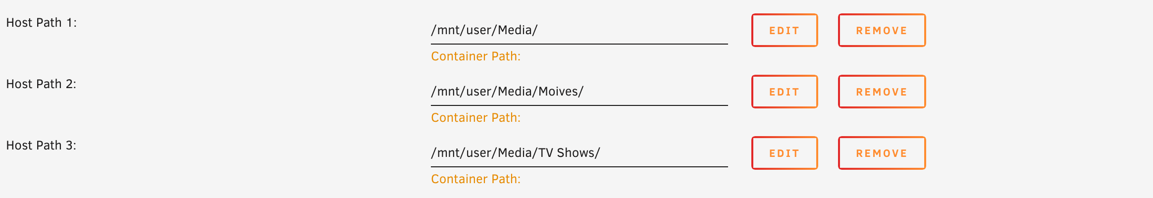

So, I am trying to setup Plex on my new Unraid server and for some reason I cant get plex to see my /mnt/user/Media/ folder so that I can upload to it. I am really really really new to Unraid and have been trying to figure this out, so that I wouldn't waste anyone's time. But Plex will not see the folder when I try to add it. It is just blank.

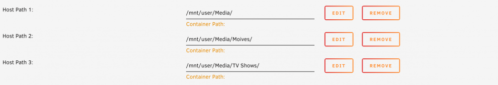

I am using limetech/plex which has the newest version and have it loaded in the docker. Host Path 1: /mnt/user/Media/ , Host Path 2: /mnt/user/Media/Moives/ , Host Path 3: /mnt/user/Media/TV Shows/
Share: /mnt/user/Media with subfolders being the above. But for some reason Plex cannot see them.
Version: 6.7.0-rc6
Thank you in advance.
You find you media in whatever the container path is you mapped the above to.  IE: If you mapped /mnt/user/Media/Movies to /movies, you look in /movies on plex

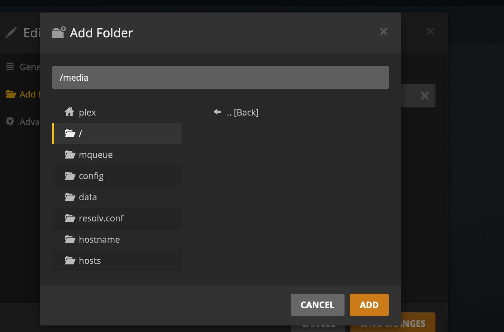

Correct. But when i go into plex ui, the folder is not appearing in plex. i go to the mnt and there are no folders.
hear is a screen shot.
Ok.  You haven't defined a container path for any of those.
Edit those mappings and make say the first one to be /Media (you don't really need the other 2 as they're sub folders from the first)
Then in Plex when you add create a library, navigate to /Media/Movies for movies and /Media/Tv Shows for TV

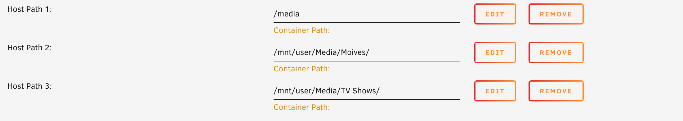

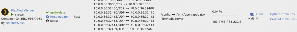

You're missing the container path.  Hit the icon on Plex and say edit  Then edit those 3 host paths and make 1 /media  2 /Movies  3 /TV Shows  Then you'll see in Plex /media, /Movies, and /TV Shows

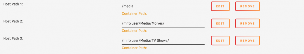

Still cant see anything on plex, I hope these screen shot is giving you the correct info
No  You just changed the Host path with was correctly pointed to the Media share (/mnt/user/Media).  Hit the EDIT button and add in a container path.
You should probably watch this video https://forums.unraid.net/topic/54834-video-guideall-about-docker-in-unraid-docker-principles-and-setup/  And look in the docker FAQ about path mappings https://forums.unraid.net/topic/57181-real-docker-faq/?tab=comments#comment-564306 (although the screenshots are out of date)
