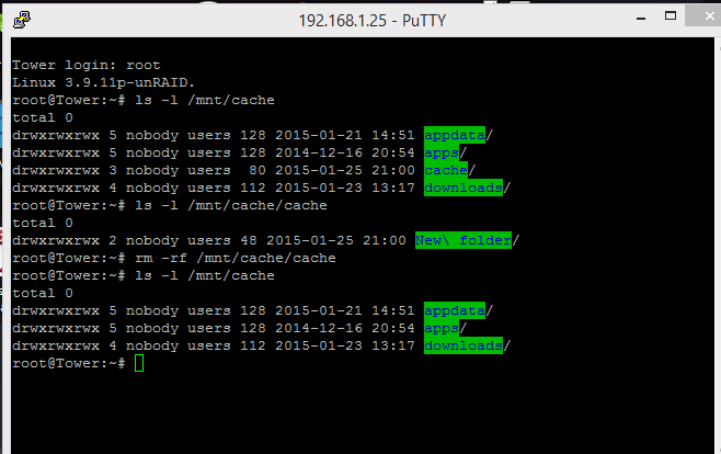

Next time you have this issue,  post of screen shot of what you see in windows, and go into the console and post the output of
ls -l /mnt/cache/Media
(Change the path appropriately)
See the picture below.
IT seems that there is a folder inside "cache" called "cache" /mnt/cache/cache/New folder
So I ran rm -rf /mnt/cache/cache to delete the second folder "cache"
From windows explorer \\tower\cache......shows "This folder is empty"
Back to command, what do the dates shown mean?

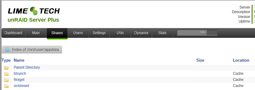

I already rebooted the server, same issue. Cache drive is: Export: Yes, Security: Public. I used to go to \\tower\cache\downloads....for example.... Now I have to type \\tower\downloads, else I would get a  "windows cannot access ................I am confused  :o see the following images. I
What are we supposed to be looking at here?  There's no downloads folder showing on the screen?  Attach the wrong picture?
