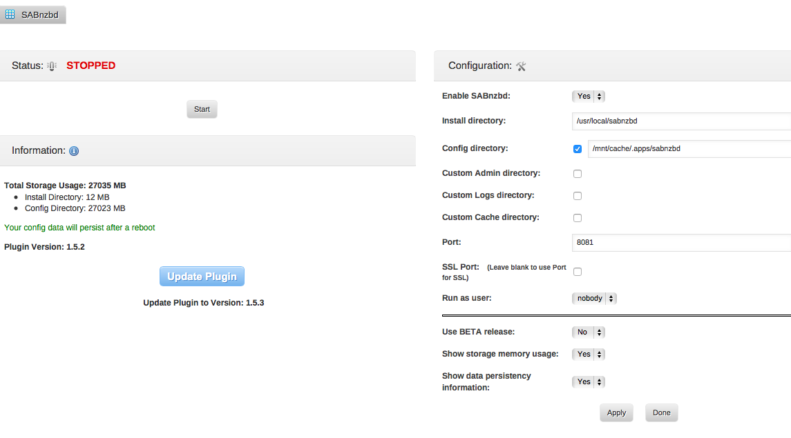

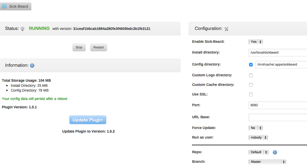

Can you post a screenshot of the unRaid webGui settings page for both Sickbeard and SABnzbd?
Maybe there is something in the configuration that is causing your problems.
Please disregard that sabnzbd is stopped.  It's working.  I just stopped the service.
This system has 4 GB.  Does this have anything to do with number of queued downloads in sabnzbd?  Does it do any processing upon startup of sabnzbd?
Sickbeard configuration page
A couple of suggestions:
[*] Try updating the plugins, they both show an update is available.
[*] On the SABnzbd settings, you could try disabling "Show storage memory usage".  You SABnzbd config directory is quite large (27 GB).  Maybe the size is being calculated during boot up and resulting in the delay?
Note: I had to disable the "Show storage memory usage" option in my Plex plugin config because of the large size of my Plex database (40 GB) because it was resulting in slow load times of the webGUI settings page.
See 4th bullet in the Notes section here:  http://lime-technology.com/forum/index.php?topic=33341.msg306949#msg306949

Thank you for the reply.  The update was just showed yesterday before I took the screenshot.  Before that, it was updated to the latest, and had the same problem.
As for the 2nd suggestion, I've read that somewhere.  But I thought the delay that it is causing is in showing of configuration settings of sabnzbd at unraid webgui page?
But I'll try it anyway.
jevans04, my sab config directory is huge since completed and incomplete downloads are both in that location.  If I were to move it into another folder, which makes my config directory small, do you think it will speed up the boot up time?  Will sab not have to process it anyway even if it's not on the same folder as it's config files?
Or is it because I have a lot on queue, and incompleted files, that it has to check?
