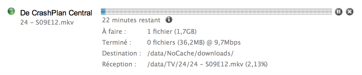

It looks fine for the restore here.  Strange it's slow on your side...
The screenshot is only showing 9.7Mbps, but after it was at 15Mbps, so it fluctuate a bit.
