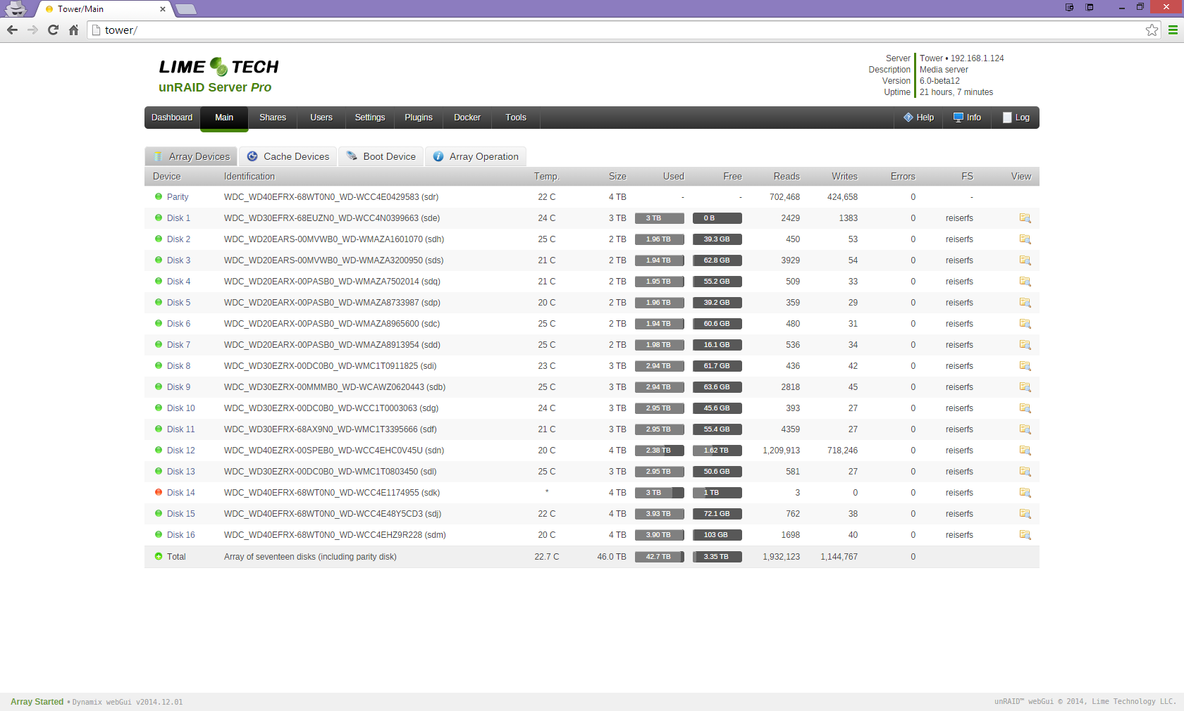

Show a screenshot of unRAID Main. Post a SMART report.
Thank you. The requested files are attached.
smart.txt
Thank you. Yeah, it's red. The whole array showed yellow, so that's what I was referring to. So at this point, it looks like my best bet is to rebuild the drive from parity. However, since I had to do a resierfsck rebuild on another drive prior to this one, I'm pretty sure parity isn't completely valid. Will I be OK to do a rebuild from parity, or am I going to have to use the "Trust My Array" procedure and potentially lose data? Thanks again.

So I rebuilt the drive, and I still got a red ball. I ended up replacing the drive, and plugging it into a different slot, but I still show a red ball. The drive is mounted as part of the array, and I have access to it, but it shows as red. I have a hard time believing that the replacement drive is also bad, considering it had been working just fine as my previous parity drive. I ran reiserfsck --check and it found no errors. I have also attached a smart report on the new drive. Any suggestions on how to proceed? It seems like the next best step is to run the "Trust My Array", but I want to make sure that's what I need to d. Thanks.

Thanks, I ran this command, but the drive still shows up red-balled. Should I go ahead and run the "Trust My Array" procedure?
Running reiserfsck does not clear a red-ball status - only a disk rebuild clears that.
What the reiserfsck did do was clear the 'unformatted' state of the emulated drive.
No. The drive must be rebuilt. If you use the trust my array you WILL lose data.
I rebuilt the drive after running reiserfsck. Not only did I rebuild the drive, which did not resolve the red ball, but I replaced it and put the new drive into a different drive bay. I am able to fully access the contents of the drive, but it's still red-balled, and I am unable to test parity.
if the drive is still red-balled after a rebuild, then that suggests there was a write failure during the rebuild.  If possible you should provide a syslog covering the rebuild period.
