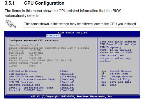

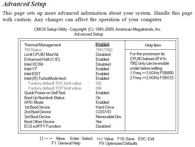

What's the output of in a telnet session? Want to see if Intel VT-d is working.
xl dmesg
Gary
root@Abeksis:/mnt/user/Backup/Windows# xl dmesg

I looked at your MB manual. ECS H55H-M. Looks like it does support it. Not sure about your CPU though. Make sure Intel VT is set to Enabled.
See my attached pic.
Gary

Your Asus P5QC shows that it supports virtualization also. See my attached pic. You can check you CPU for virtualization support at this website. http://ark.intel.com
Flaky motherboard support can be a problem though and sometimes it just won't work.
Gary
