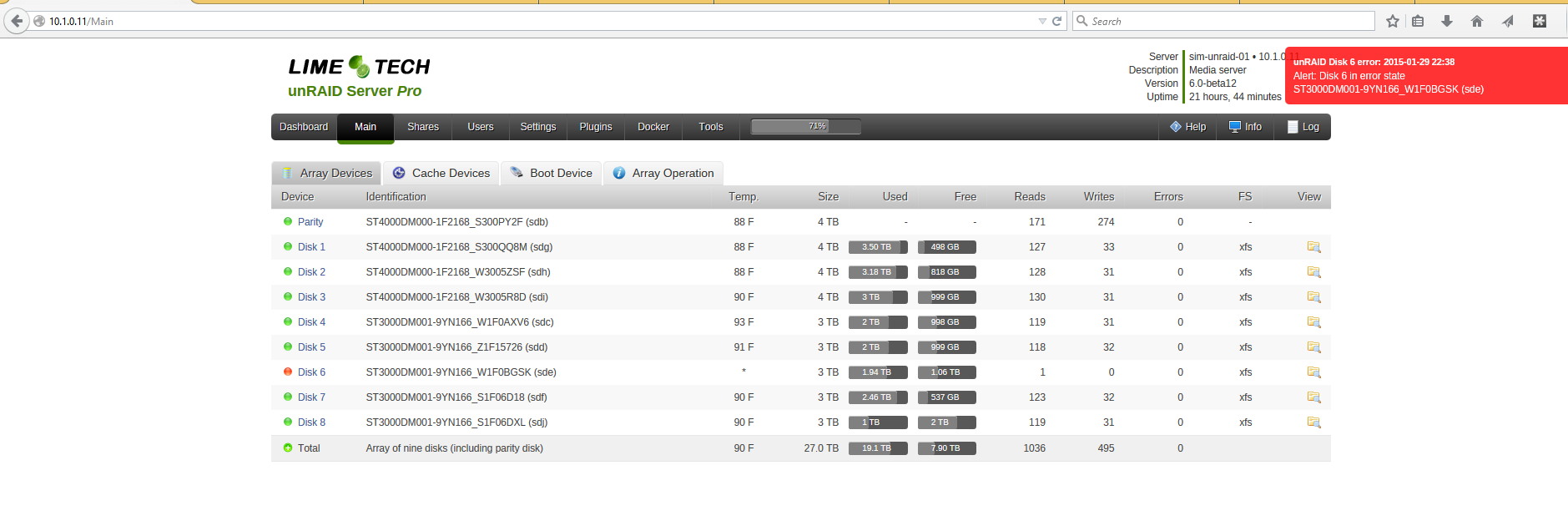

Post a complete syslog and a screenshot so we can get a better idea what you are dealing with.

Screenshot and Sys Log attached.  All the drives were added to unraid and formatted using unraid.  I am not sure if this process includes preclearing them or not.  What exactly does preclear do?

Looks like that syslog, the drive is up, but probably encountered a write error that disabled the drive.  Since it is disabled, it is emulating the drive, so you are probably best to replace the drive as soon as you can.  After you recover to a new disk, you could run a preclear to see if the drive checks out, but with the smart attributes on that drive, I wouldn't use it for any important data if it passed...
